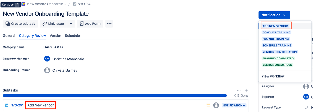

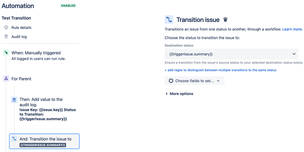

Maybe this is a bit of an unusual use-case, but here I go anyway:
I have a task with a number of subtasks underneath it.  The subtasks Summary field is the name of one of the statuses of the Parent, eg: Subtask Summary = "In Progress"
Through an automation on the subtask, I would like it to transition the parent to the status corresponding to the name of the subtask.

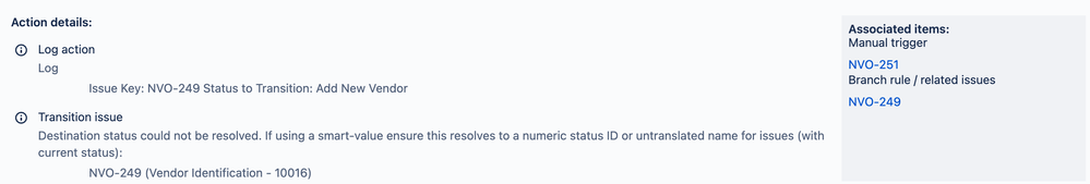

But when I do this, I get an error: "Destination status could not be resolved. If using a smart-value ensure this resolves to a numeric status ID or untranslated name for issues (with current status)"
I've looked at the documentation, online and in the community but haven't found the answer.
Here's the JIra records, automation and error.
Screen Shot 2022-01-05 at 10.38.10 AM.pngScreen Shot 2022-01-05 at 10.33.33 AM.pngScreen Shot 2022-01-05 at 10.37.29 AM.png
Thanks Heaps
David

Hi @David Stokes
Other than as an experiment, I am unclear what problem you are trying to solve by doing this.  Would you please explain?  Thanks!
Regardless of the "why", I suspect you need to use the Status Id value when performing a transition with a smart value.  Two possible options are:
  1. When you set that string value in the subtask summary, also save the Status Id value in the same summary.  Then parse it out and use that for the transition.
  2. If the first option is not possible, you could call the REST API to get all of the possible status values for the project, parse out the one you want to get the Status Id, and then use that in the transition.  That could take a few seconds per call.
Kind regards,
Bill

Bill Sheboy
January 5, 2022
Hi, David.
FYI that I tried your use case with the status Id and it worked for me.  To make it work I did the following:
  • Formatted the summary of the subtask to contain both the name and id for the status.  For example:
    • Validate: 12345
  • In my automation rule's action to transition the parent, I parsed out and converted the id value.  For example:
    • {{triggerIssue.summary.substringAfterLast(":").asNumber}}
The key is where do you get the status Id for the subtask?  You could:
  1. Enter them manually, which seems cumbersome and error prone
  2. Use the REST API technique I noted: using a web request, call the REST API to get all status values for the project, parse out the one matching the name using smart value list filtering and text functions, and then use the id for the transition.  This would match the programmatic approach you note.

David Stokes
January 5, 2022
Hi @Bill Sheboy
Thanks again for your suggestions and have got it working using the ID - the key was making sure it is converted to a number.
I'm now wrestling with the REST API technique - thanks for the links.  I'm a bit of a novice with REST API's but am learning quickly (although not as quickly as I would hope).

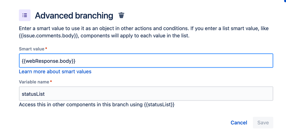

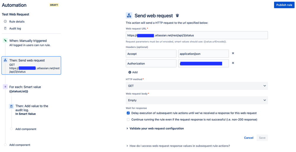

What's blocking me at the moment is
I have confirmed that https://XXXXXX.atlassian.net/rest/api/3/status does provide JSON with the status - I can show them in a browser using that URL.  But in the automation, it doesn't want to step through each of the statuses.
Here's my test automation and the web request
And the branch:Screen Shot 2022-01-06 at 12.53.23 PM.png
In the audio log, I just displayed some simple text.  But it's not showing any log entries after running the automation.  This is telling me that it's not branching.
Any suggestions?
Thanks Heaps
David
David Stokes
January 5, 2022
Hi @Bill Sheboy
OK - I figured out (well actually I got to speak to Asim @ Atlassian who helped me), and the problem was me not following the instructions (I assume you've heard of RTFM 😉) for authentication.
Once I followed this and encoded the token, it started to magically work.....
So thanks again (and thanks to Asim) for your suggestions.
Cheers
David

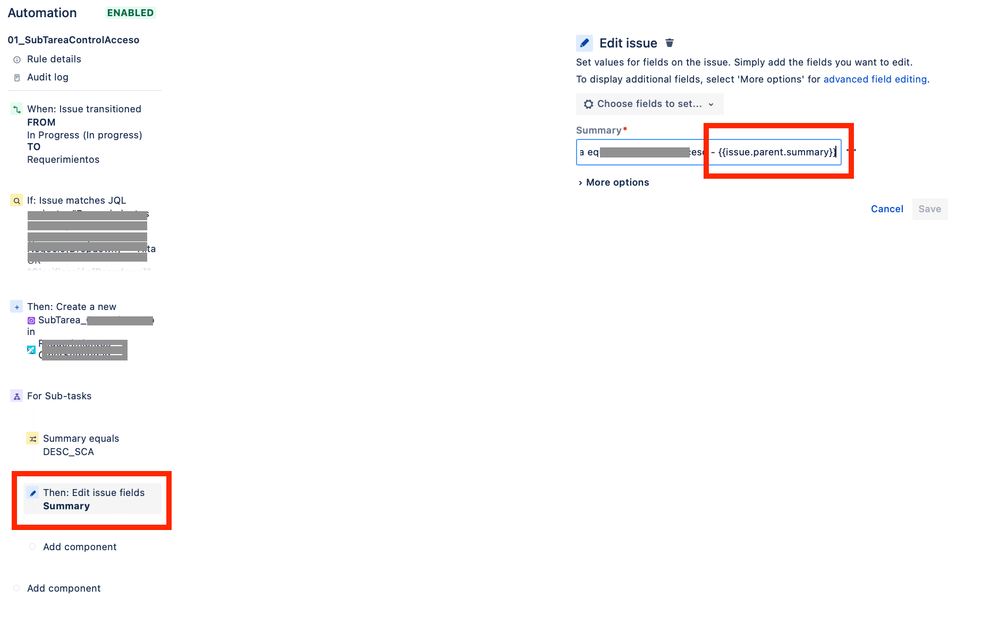

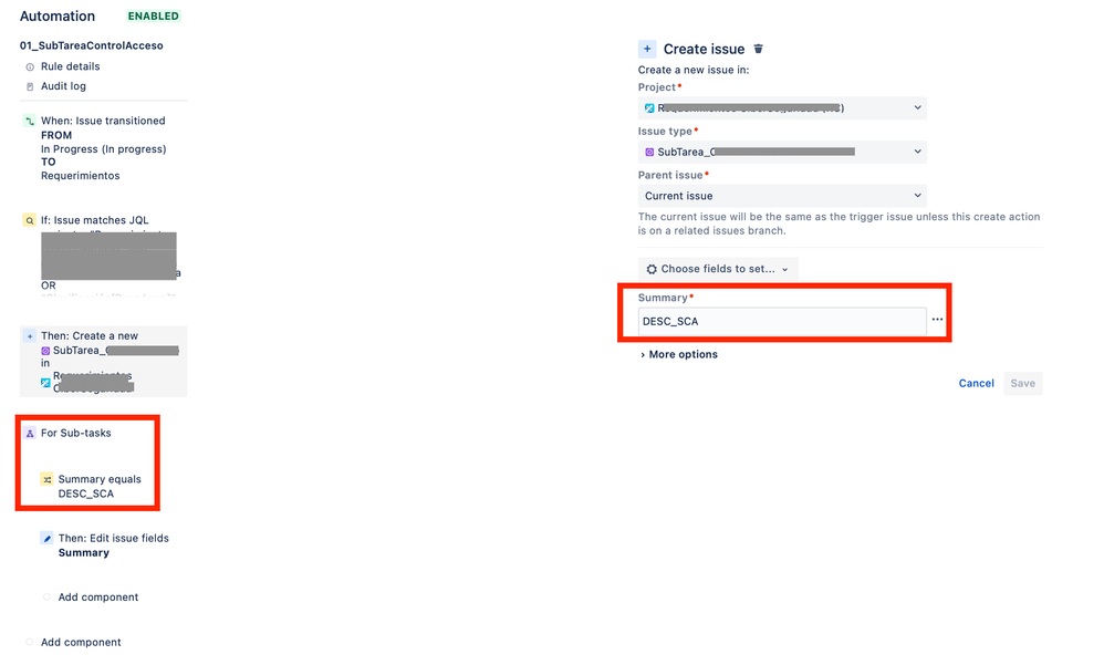

Claudio Gonzalez
January 4, 2022
Hi @David Stokes ,
Is not possible put the summary parent into a sub-task directly, you need put a summary name into sub-task first, and after change the name with the summary parent value.
