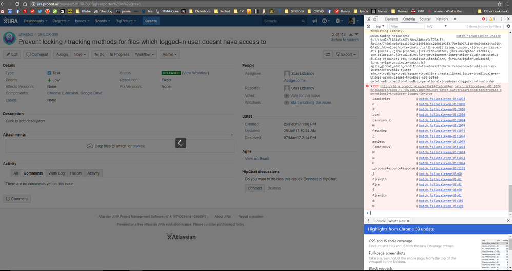

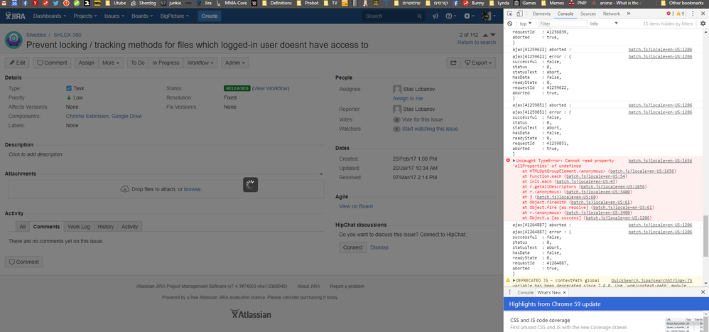

I keep getting these, please someone help
Rodrigo Gómez
July 31, 2017
This looks exactly the same as the problem I am experiencing. A 400 error when reading that file, batch.js

I have the same error when clicking inside the issue. However it appears randomly.
I have that error in the Browser's console:
batch.js Failed to load resource: the server responded with a status of 400 (Bad Request)
