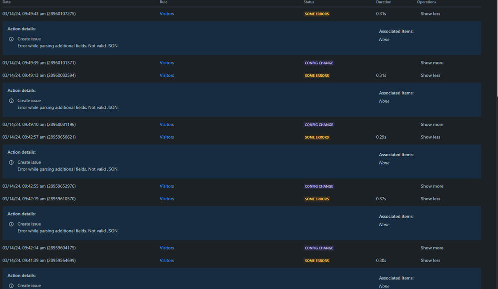

I've been racking my brain trying to get the right JSON format for an automation that runs every day.
The audit log says -
Error while parsing additional fields. Not valid JSON.
My JSON currently says -
{ "Custom Field Name": {100_93": {"value":"100_10231", "child": { "value" : "10272"}
Can someone help me in telling me what is wrong? I can supply the names of my custom fields if that's helpful.
Thanks.

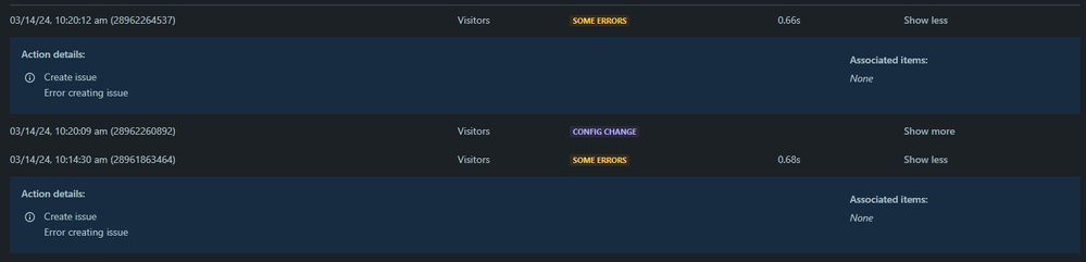

Hmm... I tried it in my test environment and it worked correctly.  Can you please share a screenshot of the audit log messaging?
Shaun Speers
March 14, 2024
Mark Segall
March 14, 2024

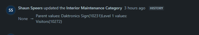

Given your last post re values... You do need to ensure the values exactly match.  Based upon the screenshot you sent to @marc -Collabello--Phase Locked-  you probably need to change it to this:
"fields": {
"customField_10093" : { "value": "Daktronics Sign(10231)", "child": { "value" : "Visitors(10272)"} }

The automation will not run, and the audit log is a bit vague. The only thing i changed was the JSON.
Shaun Speers
March 14, 2024
Mark Segall
March 14, 2024
Yeah the log is definitely lacking in detail.  Here are a couple things that I would look into:

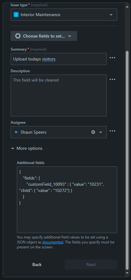

  1. Verify that all required fields are included in your Create Issue action
  2. Verify the automation rule actor has permission to create issues. Doubt this one because it will usually give you that detail but still worth validating.
Shaun Speers
March 14, 2024
The rule actor was Automation for JIRA. I went ahead and changed it to myself. Still producing the same error - a vague one.
All starred fields are correct

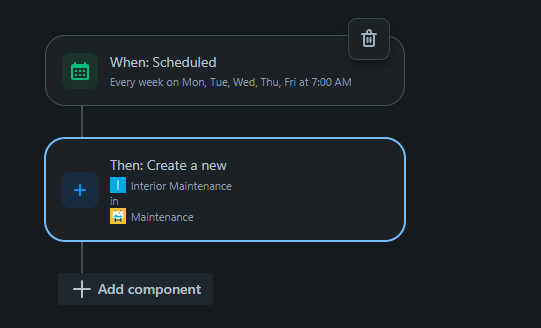

Shaun Speers
March 14, 2024
I tried duplicating the automation in my sample space. I associated the fields with that project. But not the request types. In our sample space, I changed it to just a task. It's still erroring out with the vague error.

Shaun Speers
March 14, 2024
I'm starting to think this may have something to do with the names. This is what my old issues look like with the correct parent and child values. JIRA3.PNGJIRA4.PNG
Here are the names of the fields and my current JSON.
I really appreciate the input. I'm getting the hand of JIRA but I'm definitely not a programmer. LOL!

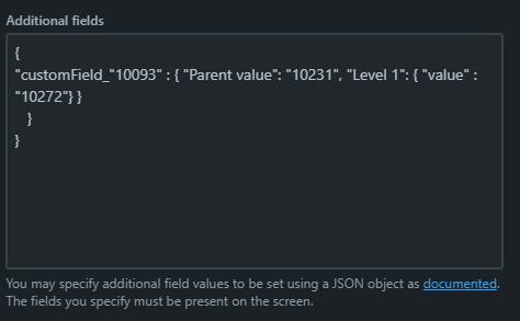

Shaun Speers
March 14, 2024
My field name is actually Interior Maintenace Category. The ID is 10093.
My parent value ID is 10231 and the child ID is 10272.
It would not work with fields, so I changed it to update field. Still getting the same error. I want to be able to set the same parent and child value to this custom field every day.
Currently looking like -
"update field": {
"100_93" : { "value": "10231", "child": { "value" : "10272"} }
