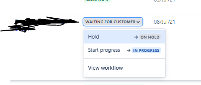

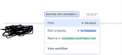

I am facing quite a strange situation. For one of the ticket in one of the project, I am not getting the transition status "customer acceptance testing". I need to move this ticket from "waiting for customer" to above mentioned status.
But, for all the rest of the tickets this is not the case. As I can move them to  transition status "customer acceptance testing" from "waiting for customer".
Please explain , if someone knows.

Garg, Prateek
August 4, 2021
Hi Alex ,
I have added the screenshot. In the screenshot you can see , that one has the customer acceptance test and another has not.
And  both follow same workflow and belong to same project,
Garg, Prateek
August 4, 2021
Hi @Alex Koxaras -Relational-  Please find the screenshot of those transition

@Garg, Prateekclick "view workflow" on each of these issues, and paste the screenshots please.
Nic Brough -Adaptavist-
August 4, 2021
Does the issue have a different workflow to the others?  (Workflows are selected based on the issue type, in the workflow scheme).  If it is using a different workflow, then check that your transition exists in the separated workflow.
If it is using the same workflow as the other issues, then you'll need to check the conditions on it - the most likely cause of this is that there is something checking the transition can be done according to current data and it is blocking the transition because something is failing the condition.
