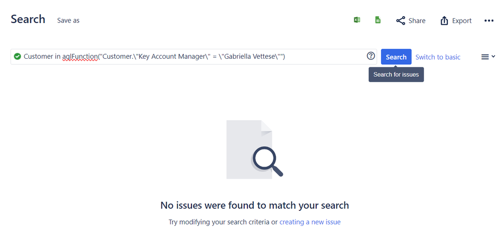

So I have the following query where I want to display all the issues of customers with Gabriella as the Key account manager:
customer in aqlFunction("Customer.\"Key Account Manager\" = \"NameXYZ\"")
There are multiple customers for which Gabriella is the Key account manager and all these issues should be displayed. There are plenty of closed and open issues connected to this customer. Issues are always connected to the customer, but not directly to the Key account manager.

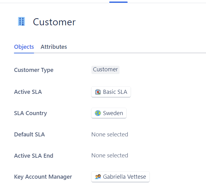

Customer example:
Do you see why the query displays nothing with this query?
Is there a better way of getting all the issues depended on a specific customer attribute?

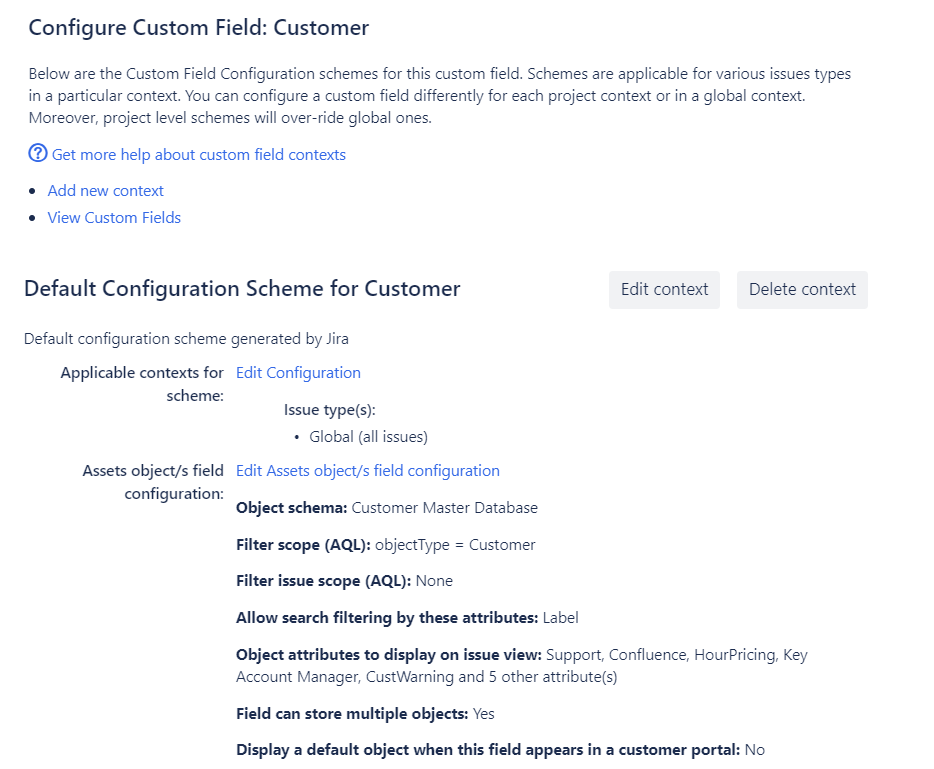

Is Customer - your custom field name in Jira, Could you also show me the customfield context configuration

see the following customer Asset field definition:Customer_field_definition.png

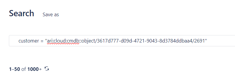

And yes you can use JQL for the customer field. Example with looking for a specific customer:
Anything you can conclude from this situation?

Uday Kiran Bhaviri
March 7, 2024
Hi @Simon Sahli
Add the other attributes other than label in your case 'Key Account Manager' in the configuration in
Allow search filtering by these attributes
Let's see if it works

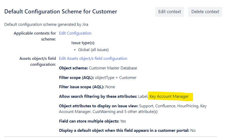

thanks for the suggestion. I have added the "Key Account Manager" field to be allowed to search (see printscreen).
I have then run the following AQL query again, but there was still no issue shown as a result:
Any other suggestions?
What I find a bit weird is that "Label" has been configured here. Like Label is only used on the issue level, but not in Assets, right?
