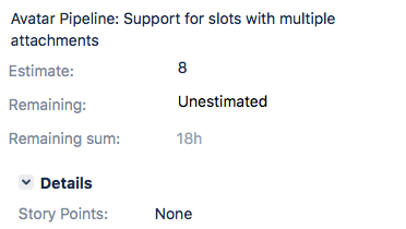

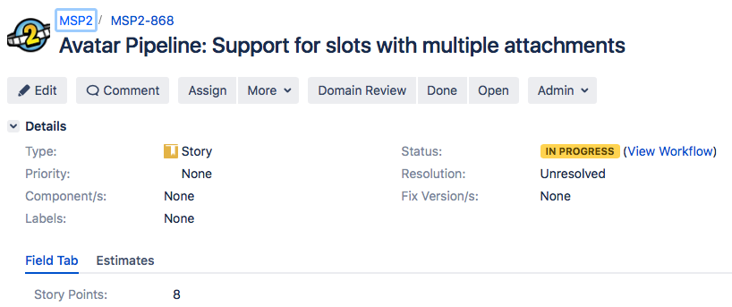

OK, this looks weird:
In the backlog the Story Points appear if they are assigned as shown in the attachment above reply to @Thomas Schlegel.
But in the detail view the SPs show up only in the Estimate field, and its says "None" in the Story Points field. (1st attachment)
But then, if I open the issue in another tab it shows up in the Story Points field. (2nd attachment)
I'm a bit lost here, I must admit.

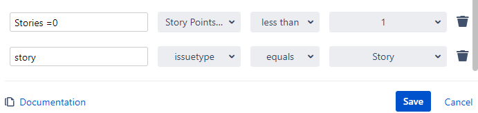

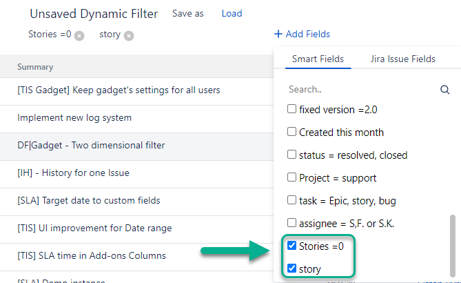

Hi @Bjarke Brint
If you won't find another solution, you can try Dynamic Filters: JQL Raplacer add-on. It's developed by my team to simplify database searches. A Smart Field Manager allows setting queries without JQL knowledge. That's how it looks for your case:
Then select created smart field – and get a result.
