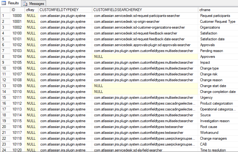

Adriana Stancu
November 29, 2018
The searcher types are
? com.atlassian.servicedesk:sd-request-participants-searcher
? com.atlassian.servicedesk:vp-origin-searcher
? com.atlassian.servicedesk:sd-customer-organizations-searcher
? com.atlassian.servicedesk:sd-request-feedback-searcher
? com.atlassian.servicedesk:sd-request-feedback-date-searcher
? com.atlassian.servicedesk.approvals-plugin:sd-approvals-searcher
multiselect - com.atlassian.jira.plugin.system.customfieldtypes:multiselectsearcher
? NULL  Approvers
cascadingselect - com.atlassian.jira.plugin.system.customfieldtypes:cascadingselectsearcher
textfield - com.atlassian.jira.plugin.system.customfieldtypes:textsearcher
userpicker - com.atlassian.jira.plugin.system.customfieldtypes:userpickergroupsearcher
sd-sla-field - com.atlassian.servicedesk:sd-sla-field-searcher
float - com.atlassian.jira.plugin.system.customfieldtypes:exactnumber
Can you help me with the corresponding values for the ones with question mark? Also take a look for the others if there may be somthing wrong.

Nic Brough -Adaptavist-
November 29, 2018
Right.  "Jira Service Desk" is not Jira, and it only works on Jira 6 and 7, so you can at least rely on the recent docs for the types.
However, it's quite likely that a load of your fields are Service Desk fields which have their own keys again.
The thing here is that you don't need to get them totally right, just right enough to make them work again.  I gave the example of a date/time field, but that type of field would also rescue plain date fields.   You'd see the fields working, but with all the times showing as 00:00:00.
Another one would be user fields - participants is a very specific user type of field, but if you just set it to "multi user picker", you will get that working again, as it has the same sort of data in it.

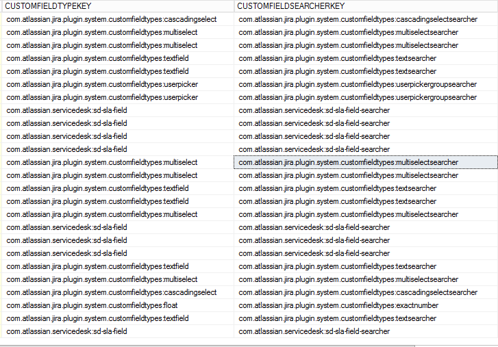

Adriana Stancu
November 29, 2018
I updated the table as follows:
Adriana Stancu
November 29, 2018
But the same error:

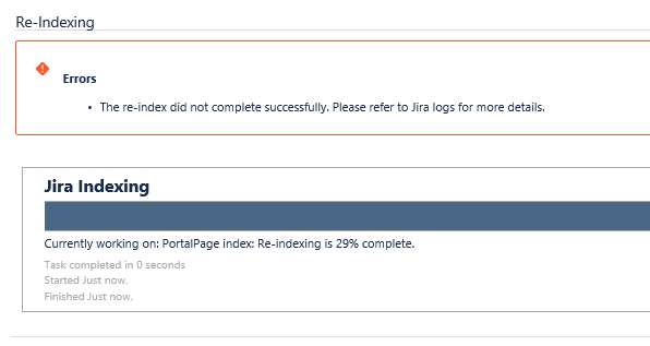

2018-11-29 19:29:41,555 JiraTaskExectionThread-1 ERROR admin 1169x139x1 ylmqcl 0:0:0:0:0:0:0:1 /secure/admin/IndexReIndex.jspa [c.a.j.util.index.CompositeIndexLifecycleManager] Reindex All FAILED.  Indexer: DefaultIndexManager: paths: [D:\Application Data\caches\indexes\comments, D:\Application Data\caches\indexes\issues, D:\Application Data\caches\indexes\changes, D:\Application Data\caches\indexes\worklogs, D:\Application Data\caches\indexes\plugins\servicedeskcannedresponses]
com.atlassian.jira.index.IndexingFailureException: Indexing completed with 24 errors
