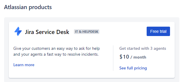

1. How to buy JIRA Service Desk? In a separate bill?
2. How to integrate JIRA Service Desk with our existing JIRA Software? Is this for free? Where can I get support or documentation on the steps to follow? I have read there is Exalate tool that can help but what are the options?
Bryan Trummer
November 1, 2018
Hi Carmen, welcome to the community.
1. If you go on your cloud instance to navigate to the navigation button to the Administration button. Under subscriptions & billing there will be an option to "Discover Applications". From here you will be able to add JIRA Service Desk to your instance which includes the free trial.

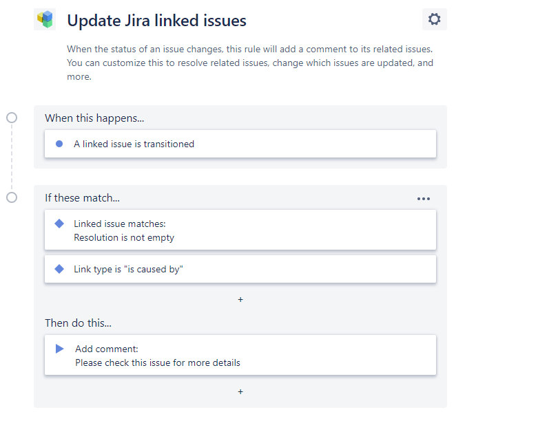

Yes the option I mention is for a same instance. There is an option in Service Desk that allows for Automation and one of those functions is to update Linked Issue Statuses which should help you achieve what you are looking for when it comes to the statuses. The following link talks a bit more about automation in the service desk projects and a screen shot of the sample of linked issue statuses.
I am not very familiar with Exalate or have not used it in any of my previous experiences.
https://confluence.atlassian.com/servicedeskcloud/automating-your-service-desk-732528900.html

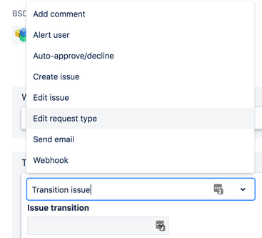

As suggested by Bryan, many effects may be achieved with Automation, that comes in with Jira Service Desk.
However, you would be limited to only the following actions:

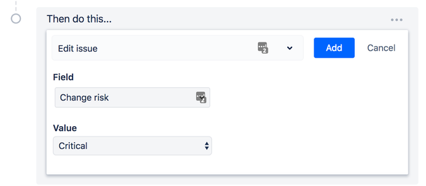

And, within the most important actions (transition and edit issue) you would also suffer certain incapacities:
* transition - you need to choose between the transitions to be triggered, however, if your issue is not in the proper status, when the automation is executed, automation would be in a pickle
* edit issue is forcing you to hard-select the value to choose (so you would not be able to populate a custom field on service desk with a custom field value from development, such as for instance "Root Cause")
