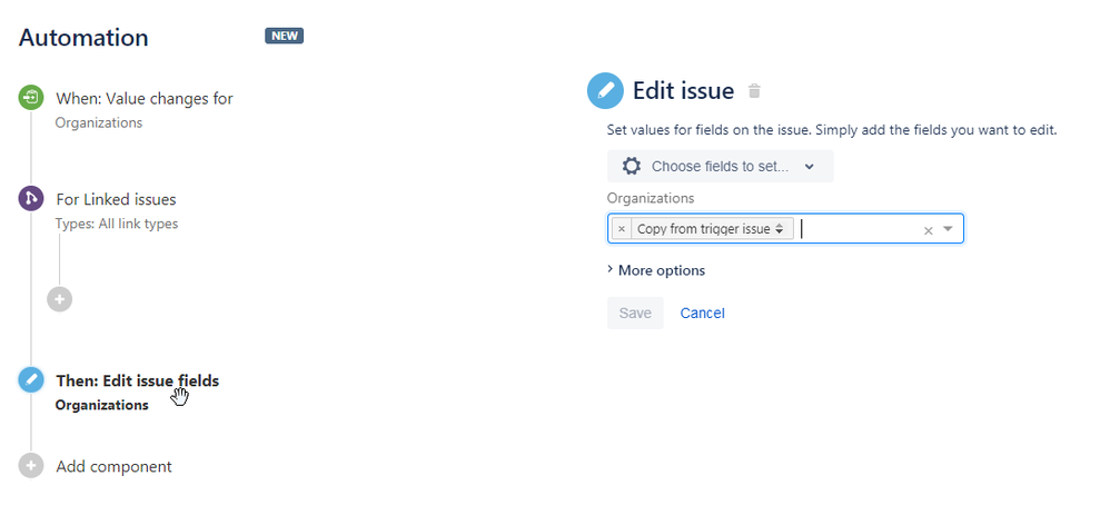

Meg Holbrook
June 6, 2018
I think you could definitely get Automation for JIRA to work this out. I'd advise from a scriptrunner perspective, but I'm SO BAD at code.
Here is a quick mock of something I think would work (haven't tested, but it's a start).
For example:
- SoftwareTicket-12 is linked to JSDticket-5
- Organization in JSDticket-5 is changed --> Kicks off the automation from SoftwareTicket-12
- JSDTicket-5 copies the value from the organization field to the SoftwareTicket-12

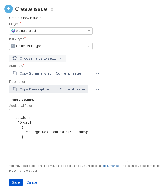

Andre Schäfer
June 7, 2018
Hi,
thanks a lot for your answer!
I've found a little different solution. Because you cannot reuse the "Organization" field from Jira Service Desk in Jira Software (according to this issue https://jira.atlassian.com/browse/JSDSERVER-5291 ) you have to create a custom field to put the info to.
I've created an custom field called "Orga" in my project and get the info by using smart field values, which are available.
"update": {
"Orga": [
"set": "{{issue.customfield_10500.name}}"
In my case, the "Organization" field has the ID customfield_10500.

Dayvis_Apolinário
May 8, 2019
@Andre Schäfer
Hello!
I need to solve this same problem. What screen is this from the image above and where do I find it?
Deleted user
May 8, 2019
@Dayvis_Apolinário
This screen is from Automation for Jira . You can find it in Administration -> System -> Automation -> New action -> Create Issue
