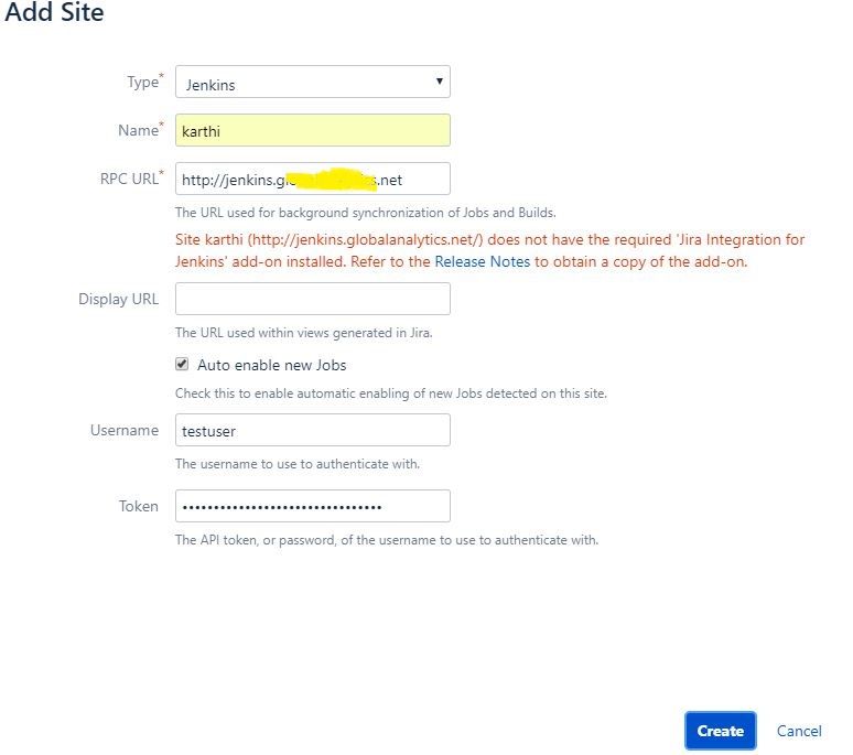

Hello,
 I am trying to integrate Jira cloud with Jenkins server ( installed in AWS ), where I am
 using http://marketplace.atlassian.com/apps/1211376/jenkins-integration-for-jira  add-on for this integration.
I am getting some issues while adding the site ( Jenkins RPC URL ) in this add-on. Can anyone know the steps for this integration?
Attaching the error screenshot for reference.

Mark Rekveld - Marvelution
July 24, 2018
@[deleted], as the message stated you need the 'Jira Integration for Jenkins' plugin not the 'Jira plugin'.

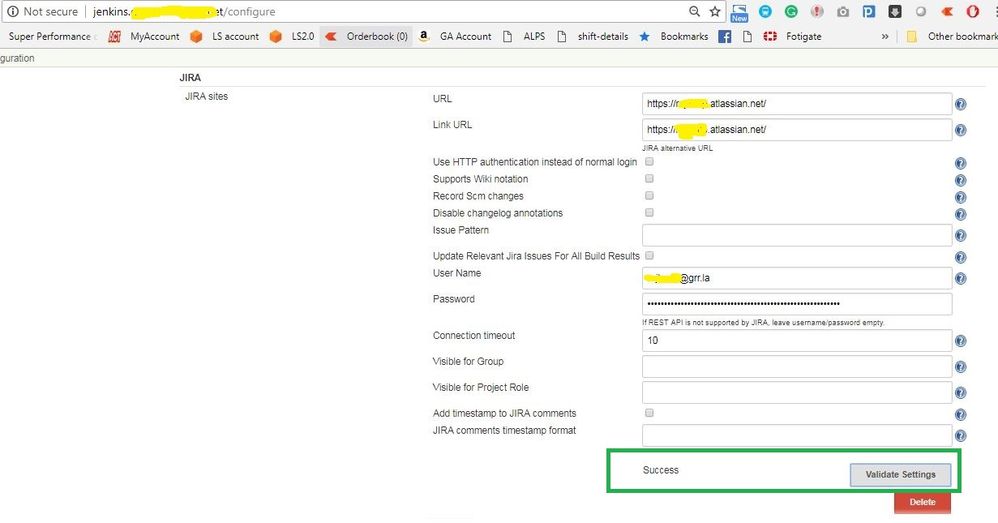

Deleted user
July 24, 2018
Hello @Vickey Palzor Lepcha @Mark Rekveld - Marvelution Thanks for your swift response, I have already installed this "JIRA Plugin" in my Jenkins server and configured it to integrate with my JIRA cloud account successfully (below screenshot fyr) where I'm facing problem on the other end integration JIRA - Jenkins.

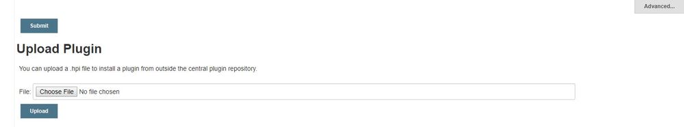

July 24, 2018
You can also download the plugin and upload and install manually in your Jenkins ServerCapture.JPG
July 24, 2018
Hi @[deleted]
@Vickey Palzor Lepcha is correct, you need to install the counterpart add-on in Jenkins as well. Follow the link Release Notes in the message.
There you can download the Jenkins add-on that will allow you to integrate the two.

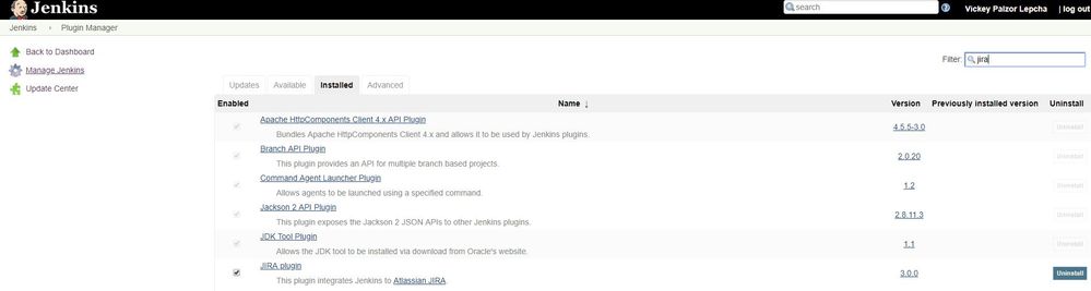

July 24, 2018
I'm not sure about the integration between the two - but by looking at the MESSAGE - it seems you may have to install a plugin on jenkins server end as well.
