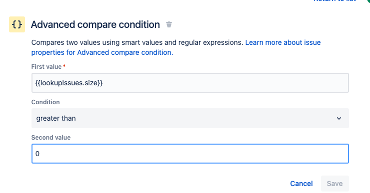

To check the number of results returned you would use an Advanced Compare thus:

This worked.
Used "Related issues condition"
issuetype="Manufacturing Code Request" and "MFR Code" ~ {{triggerIssue.MFR Code}} and key != {{triggerIssue.key}}
