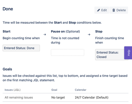

1. Setup your SLA:

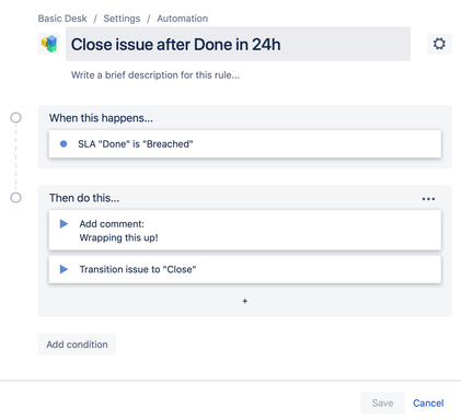

2. Create new Automation to transition the status to close.
