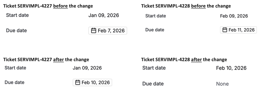

In the example below, ticket SERVIMPL-4227 is blocking ticket SERVIMPL-4228:
Could someone please advise how to preserve and correctly update the Due Date so that the original duration of the dependent tasks is maintained?

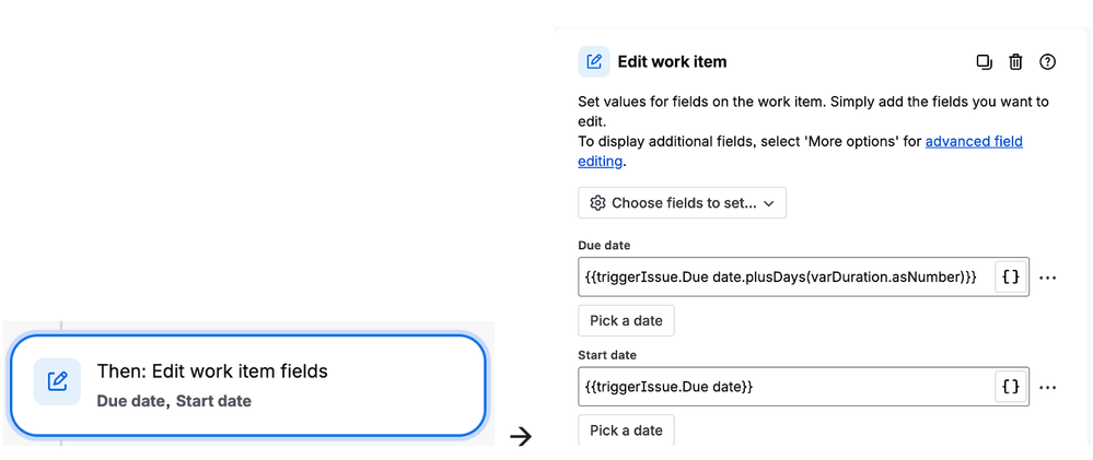

I would recommend also just before the Edit action you add Log actions to log the following:
{{issue.Due date}}
{{issue.Start date}}
{{varDuration}}
{{triggerIssue.Due date}}
{{triggerIssue.Due date.plusDays(varDuration.asNumber)}}

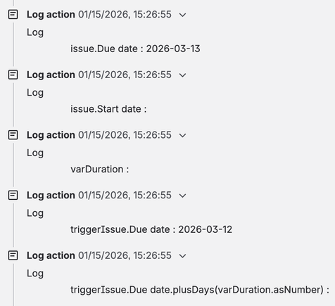

Thank you, @Trudy P Claspill and @John Funk   , for your feedback.
I’ve implemented your recommendations by adding a Re-fetch action right after the trigger, and I’ve also added Log actions.
As shown in the logs above, issue.Start date returns an empty value, which is likely why this rule isn’t working.
Do you know what could be causing this, and how I could resolve it?
Thank you for your help.

Trudy P Claspill
January 15, 2026
Thank you for that additional information.
Can you show us the details of the Log action for logging Start date, so that we can verify there is not a type in the smart value?
It is possible that there is more than one field in your system named "Start date" and the automation is not able to reference the correct one with only the field name. You may need to reference it instead by its ID; i.e. customfield_12345.
Review the documentation below for information on how to find the ID for fields used in your work item. Let us know if you have questions.
https://support.atlassian.com/cloud-automation/docs/find-the-smart-value-for-a-field/
