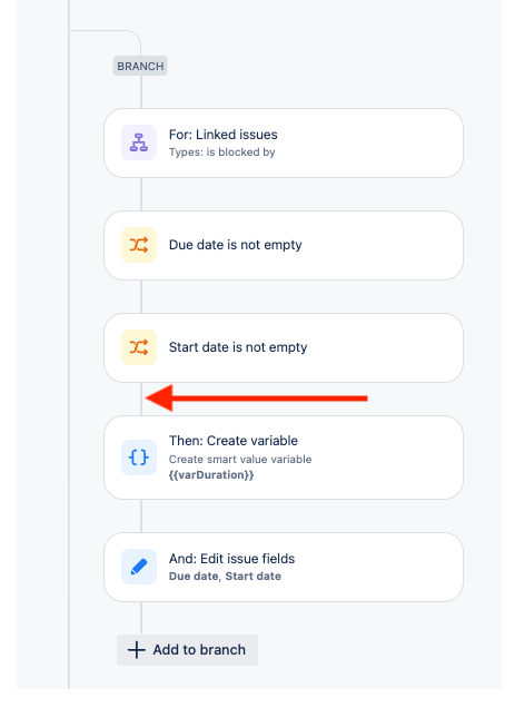

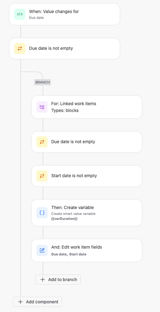

Here is a summary of the rule:

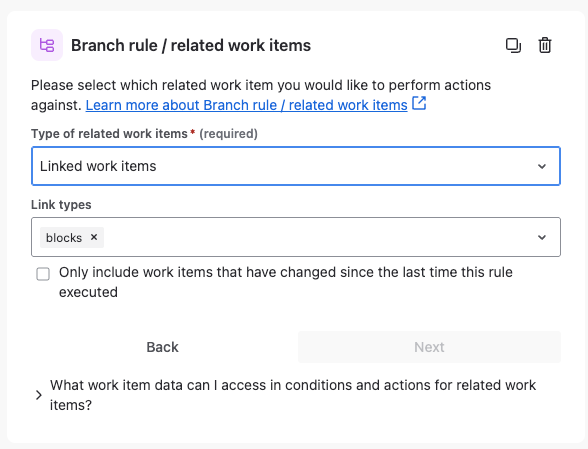

Note that in the Branch component you will want to uncheck this box:
The rule components that need more explanation are the last two; Create Variable and Edit Issue Fields
To get the original duration of the dependent task we get the difference in days between the original Start date and original Due date using smart value function diff() described in Automation smart values - date and time . We store this in a variable for use in the next step of the rule - Create Variable.
Note: You can alternately get the duration in business days by using businessDays instead of days.
In the Edit Issue action we use smart values to set the Start date and Due date to new values for the dependent task.
The dependent task’s new Due date is its new Start date plus the number of days calculated as its duration. We stored the duration in a variable we created earlier. We can use the plusDays() function to add that variable value to the new Start date to get the new Due date.
We are changing the Start date in this same Edit Issue action. To avoid any collisions in changing data we will reference the trigger issue’s Due date in setting both the new Start date and Due date for this dependent task.
Start date: {{triggerIssue.Due date}}
Due date: {{triggerIssue.Due date.plusDays(varDuration.asNumber)}}
Variables are stored as strings, so we use asNumber to convert that to a number for this calculation.
When the rule execution completes it will have updated the Start date and Due date of the dependent task. Because it updates an issue Due date, that will cause this rule to be triggered again, with the task just updated becoming the triggering issue for the next execution.

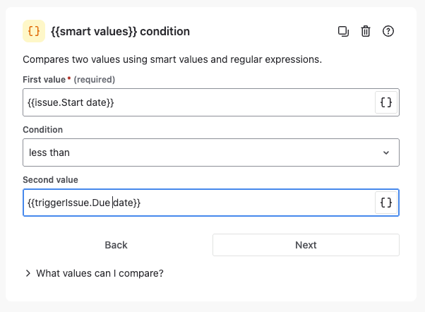

Is it possible to include a condition into the whole rule flow, that if A2s start date is still later than the changed due date of A1 nothing is changed (like the tasks are not yet overlapping)? That the start date of A2 is only set to the changed A1 due date, if the original A2 start date is sooner/behind the A1 new due date (like the tasks overlapping)?
Like # people like this
Trudy P Claspill
September 24, 2025
Hello @Isabelle Saalfeld
Yes, you could do that by adding a condition in the branch here:
This is the condition:

Only one small thing I came across:
When I implemented the rule with "For: linked issues ¦ Type: is blocked by" I came across the same issue as @Peter with having just the template settings for definition of "blocks" and "is blocked by".
I then changed the rule definition to "For: linked issues ¦ Type: blocks". Now it works as expected and the dependent issues move automatically up in time as soon as the predecessor task has a later due date than the depending tasks start date.
