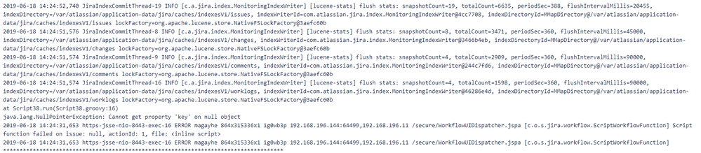

I added the above script and took a screenshot of the logs. Not exactly sure what I'm looking for, but this is what came up -

the line where it says "can't get property 'key' on null object is enough"
looks like it can't find the third issue
try moving this postfunction to the very end of postfunctions list
ps: I believe logs written by the postfunction should be found in it's info, dunno how better to explain it

I really appreciate your patience and responsiveness. I moved the post function to the very bottom of the list with the original script you provided. I am getting errors, and I do see it in the logs.
Maybe I have my data inputs to your script incorrect. For instance, when I type "Test3" into your script I am referring to the Issue Type that is being created. The same Issue Type that the post function script is being configured on.
I apologize for all of the confusion. I will continue to test things out different ways.LOGS.2.PNG

though all that patience still isn't getting us anywhere
the errors still mean that it fails to find that third issue, meaning that somehow it's not linked to the main one at the moment we are executing the postfunction, that's my only guess. though i feel like it should
hard to debug remotely
