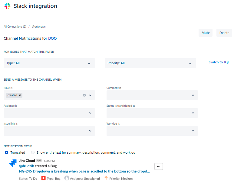

The conditions I'm talking about are these two:
  1. If they have issues with no story points assigned for the following sprint
  2. If the sum of all the story points assigned is bigger to a specified number
I have found some notifications available, these are the ones attached via the photo. But these dont seem to solve my issues. Captura de pantalla 2021-08-30 122623.png
If there is no way to get these alerts via Slack, I'd also be greatful if i could get that info through other means, like via the Slack app.
Thanks
