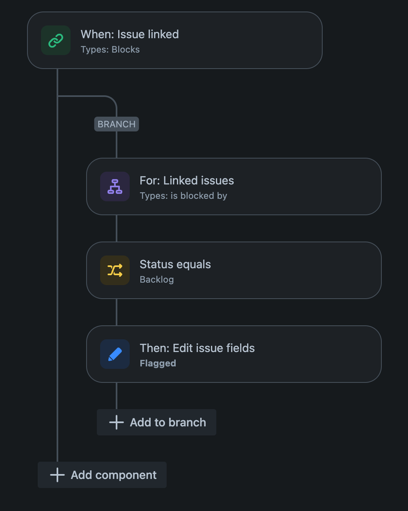

Adding the flag automation:
  • Trigger: When issue linked - Blocks
  • Condition: For linked issues - Type: is blocked by
  • Condition: Status equals - backlog
  • Action: Edit issue fields - Flagged: Impediment

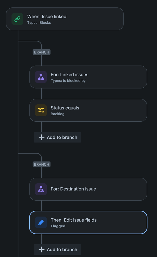

The problem I'm having is that I only want to flag the issue that is currently blocked (not the ticket that is blocking it). I have tried using [Condition: For destination issue] but I can only add it on another branch which makes it look like this and doesn't execute properly (I'm assuming because it's on another branch):
  • Branch 1:
  • Branch 2:
    • Condition: For destination issue

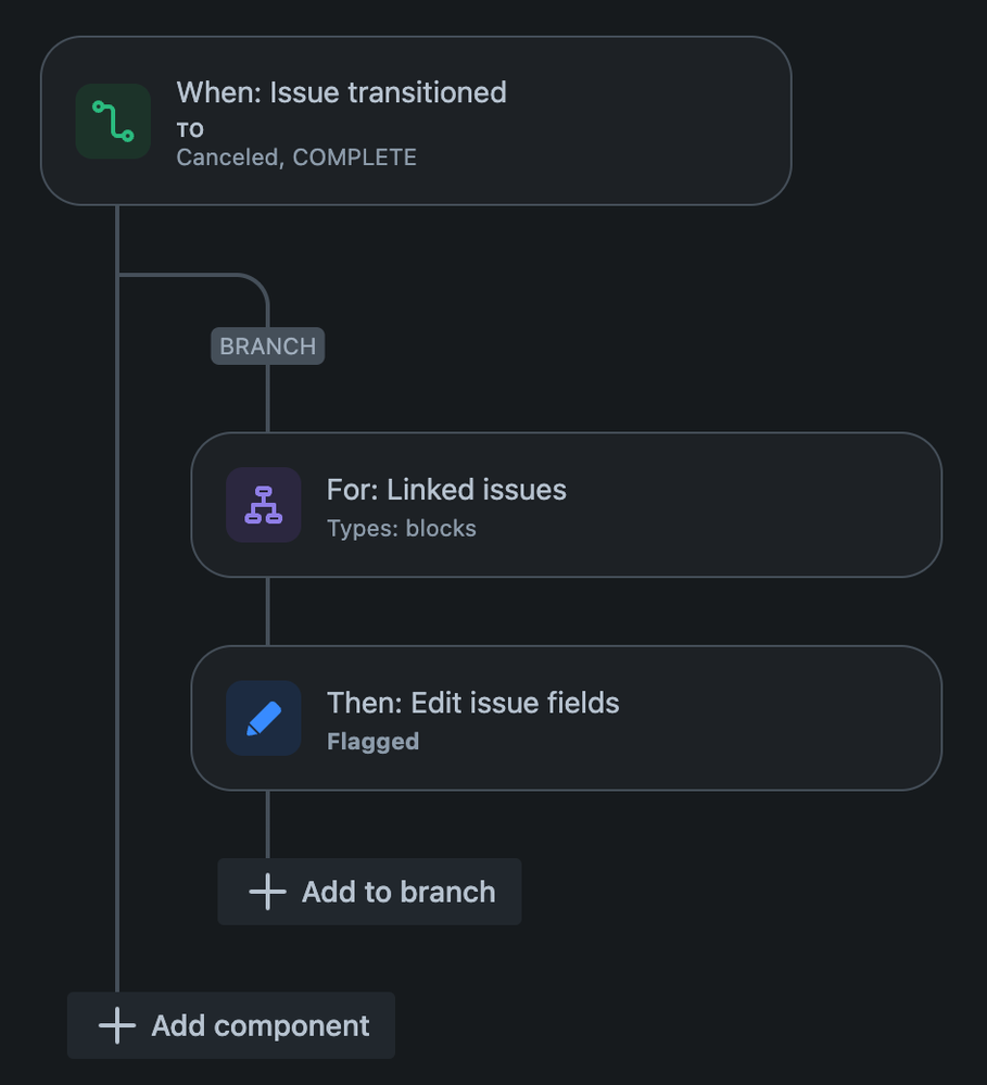

I'm not sure if that will cause a similar problem with removing the flag from the ticket. What I currently have for that automation is:
  • Trigger: When issue transitioned to - Cancelled, Complete
  • Condition: For linked issues - Type: block
  • Action: Edit issue fields - Flagged: [empty]

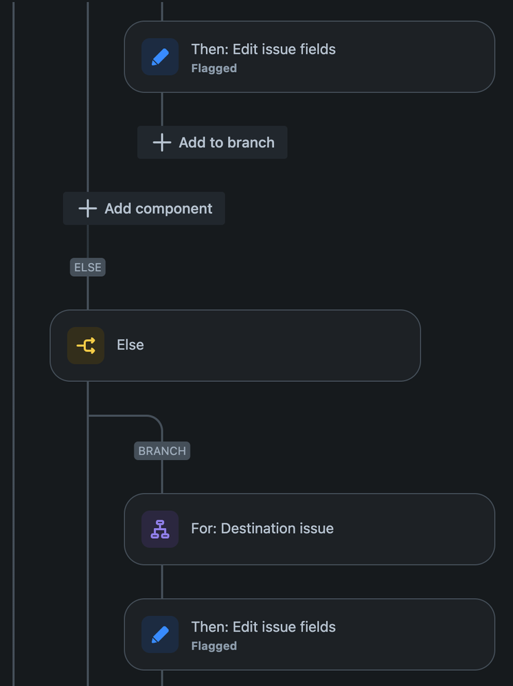

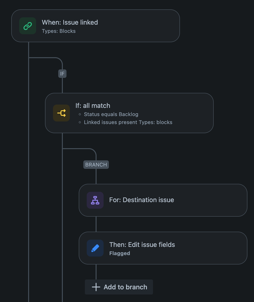

I believe I was able to get the initial part of the problem working, the "Flag Blocked Tickets" automation, which is what I was explaining to you before. I used an if-else condition to specify that parameters I explained previously. I have included a look at that below:
I tried to use the else in the above automation to remove the flags from the tickets but that didn't seem to have an effect and I wanted to get your input on that. Below, I have included what I attempted to do in the else (continued on after the previous image):

I would like to do this whenever a ticket is transitioned, but unfortunately I cannot specify destination ticket when I am using the the Issue Transitioned trigger. This is why I tried to do this in the else statement from the original automation but the flags were not removing (Flagged parameter is empty in the else statement). Automation below:
Do you believe there is a way to achieve this in the "Flag Blocked Tickets" automation (the one with the if-else statement)? If not, how would I do achieve this in a new automation?

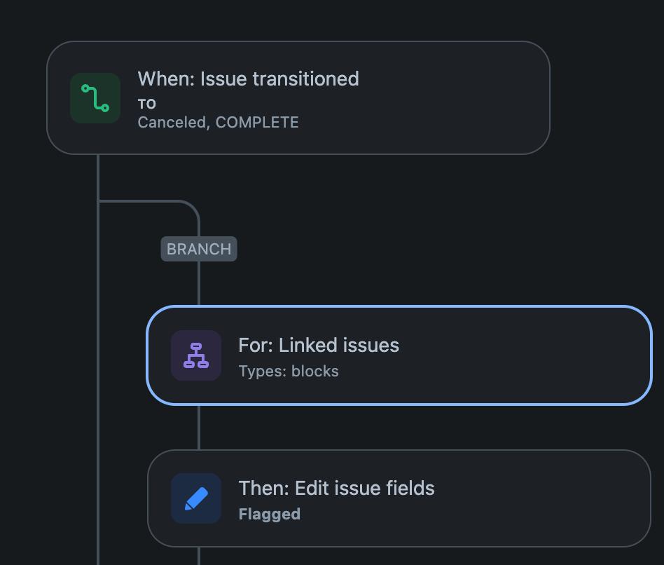

Bill Sheboy
March 28, 2024
As your first rule is triggered by the linking, it cannot also remove the flag: the triggering event is different.
For your second rule, you do not need to use the destination issue from the first rule, as the branch can be used instead to find the issue with a condition on Flagged:
  • trigger: transitioned to Canceled or Complete
  • branch: to linked issues, of types "Is Blocked By"
    • condition: issue field Flagged has the value you selected earlier
    • action: edit issue to clear the Flagged field
Have you tried that approach yet?
Rachel Godina
April 1, 2024
Yes, I had this originally but in my confusion, I changed it. I have created the automation following the steps you gave and so far everything seems to be working great! I will continue testing and troubleshoot if I have any issues. Thank you so much!
