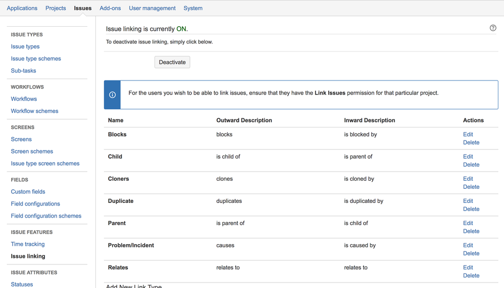

If that can't be done, you might try to navigate within JIRA to Cog Icon -> Issues -> Issue Features -> Issue Linking.  From here you can define the issue link types that exist here.   One way to get around this would be to create an inverse link type here for each if needed.   So say you already have a link type called "Parent".  What you could do would be to create a new link type called "Child" that has the inverse of the inward and outward descriptions of the Parent link type.
This is one way you could then try to import this data to make sure the issue link relation is still clear to the users.

But then - when a user will try to create a link, he will see "is parent of" twice and "is child of" twice.
Also some of the issues will be parent-outward and some parent-inward. which semantic is the same but is technically different.
