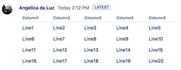

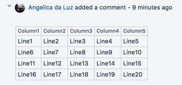

I've tested adding a table on a comment on Jira and then checked in the portal and it looks different, but I was able to see the table normally.
If it's showing different from the above, can you please send us a screenshot?

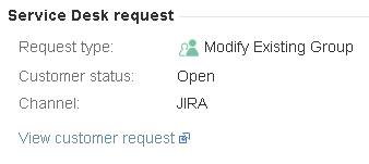

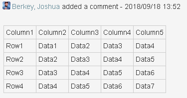

Thanks for the response Angelica. The issue I have is within Jira Server and is different based on the Channel the ticket originates from. So if a ticket is created via the Agent view (JIRA Channel) that tables show up correctly like this:

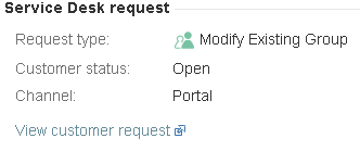

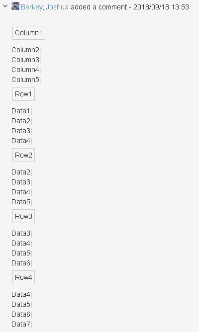

However, when a ticket is created via the Portal Channel and a comment is added via the Agent view this is how the table shows up:

I was able to test Jira 3.15.1 and Office365, but after many tests using chrome, safari, office, google sheets we've discovered that it's not related to any spreadsheets software, but with the text editor of Jira and it only happens if the ticket is edited on the queue.
The bug below is related to this issue where the Jira's own table get incorrectly when posting the comment.
- https://jira.atlassian.com/browse/JRASERVER-67329
Can you please go to Issues > Search for issues and add a comment by pasting a table from excel?
Regards,
Angélica
Josh Berkey
September 27, 2018
Yesss! That's it! It's the queue view of the ticket. If it is in that view, it doesn't matter if the ticket was created from the portal or agent channel. As soon as I open the ticket in the other view, it works perfectly! Thanks for the help on this Angélica!
