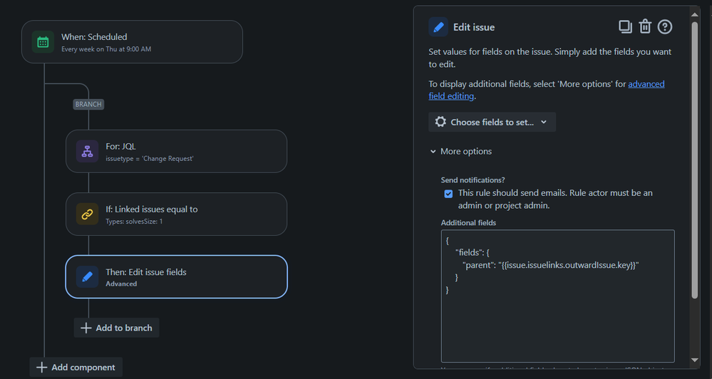

Hello all,
I have 2 issue types, 'Eng.Problem' and 'Change Request' (CR). Their issues are connected with a custom link 'solves - is solved by', where a problem is solved by one or more CRs and a CR solves exactly 1 problem.
This worked fine, until we decided that we want a parent-child relationship between them. So I 'upgraded' Eng.Problem to level 2 hierarchy and CR to level 1, so now a CR can be the child of a problem.
The final step is to take the linked problem from every CR and assign it to the parent field. I tried to do it with an automation but I keep getting the same error (data was not an object(parent)).
2 votes
Sebastian Krzewiński
August 1, 2024
Hi @d.kamposos
I think you are using wrong json to set parent. Please check this thread - https://community.atlassian.com/t5/Jira-questions/how-to-update-the-parent-field-of-an-issue-with-API/qaq-p/2574491
Regards,
Seba
d.kamposos
August 2, 2024
Thank you @Sebastian Krzewiński , that's what I needed!

Bill Sheboy
August 1, 2024
Hi @d.kamposos
Please post an image of the audit log details showing the rule execution.  That may help provide more context for this symptom.  Thanks!
Until we see that...
You could restructure your rule to only process when there are issues to update.  For example...
  • trigger: scheduled with JQL to find CR issues without a parent and which have your linktype
  • action: edit the parent field directly, setting the value to the smart value expression for the linked Problem issue
  • Do you also want to remove the link after setting the parent?  If so, continue the rule with...
  • action: re-fetch issue
  • action: delete the issue link of the specific type
Kind regards,
Bill
d.kamposos
August 2, 2024
Hello @Bill Sheboy
My problem was the wrong JSON format that I used, so I accepted Sebastian's answer, but thank you for always being helpful and pointing out additional concerns!
