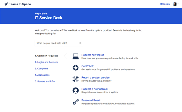

A Jira Service Desk project embeds a customer portal in which customers can raise requests. You can create several request types in one customer portal. This screenshot shows it well:
This is a customer portal containing several request types: Request new laptop, Get IT help, etc.

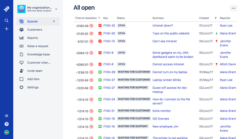

You can then retrieve all created requests through your project queues:
