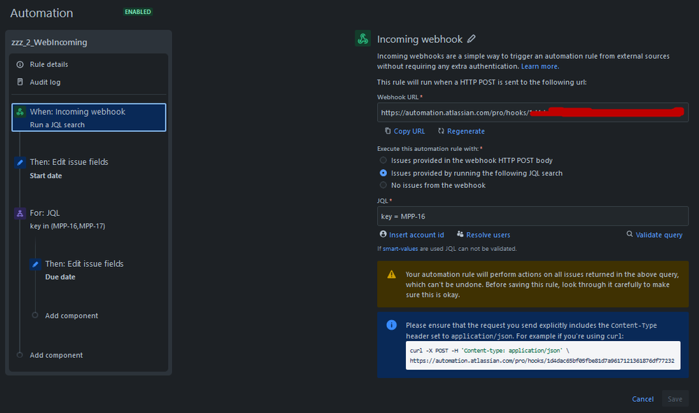

Hello!
I have an Incoming webhook executed with "Issues provided by running the following JQL search" option. Definition JQL: "key = MPP-16"
We update start date on this issue in a first component edit issue, MPP-16 edited okay!

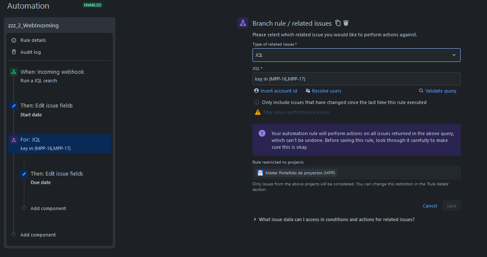

Then, execute the branch FOR: JQL "key in (MPP-16,MPP-17)"
And edit duedate in both issues, on MPP-17 this work, but on MPP-16 not.
Can someone tell me why?
Screens:

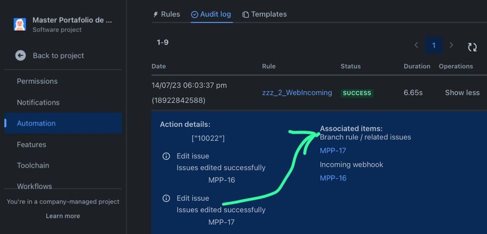

Does the Automation rule's log show any clue?
Marcos Milanesio
July 15, 2023
Hi @Jehan Bhathena
This is the log:

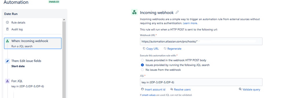

I created a similar rule at my end, and turns out I face the same behavior.
In order to work around it, I kept the JQL for the incoming webhook, and the Branch condition to be the same :
I did not find any documentation that mentions this exclusion or vague behavior, but I did find a few old community posts that MIGHT point to the same thing :
Tagging @Bill Sheboy, since he provided some good inputs to the other threads.
Like Marcos Milanesio likes this
Bill Sheboy
July 16, 2023
Hi @Marcos Milanesio and @Jehan Bhathena
That symptom is curious...
I have observed there are some single-issue related triggers, which later in a rule exclude the trigger issue from some branches (like on JQL), which I hypothesize is to prevent errors / loops.  Although I have not found this documented for automation rules, and so I would welcome an Atlassian employee to confirm this...
Marcos, a work-around for your scenario is to first update the trigger issue directly with an edit and then branch to the other issue.
