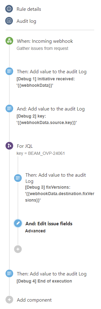

My use-case involves triggering a project automation rule using an incoming webhook  from another project automation rule on the same Jira server. The send- and receive webhook works great and can exchange data.
Incoming Webhook Rule

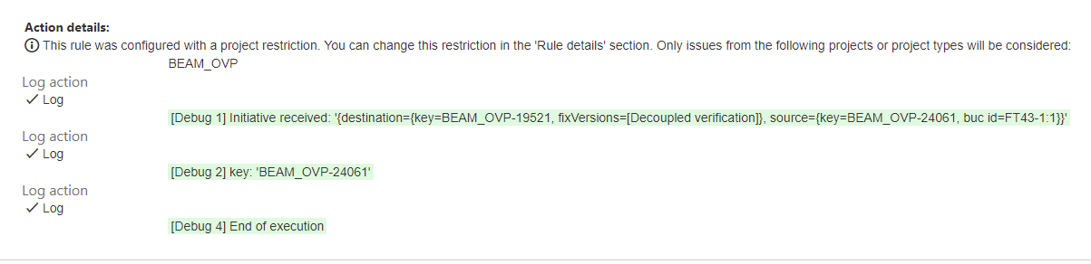

However, the branching on JQL is never executed for my receiving rule as is evident from the below audit log as Debug 3 tag is not shown in audit log. The rule skips branching and goes :

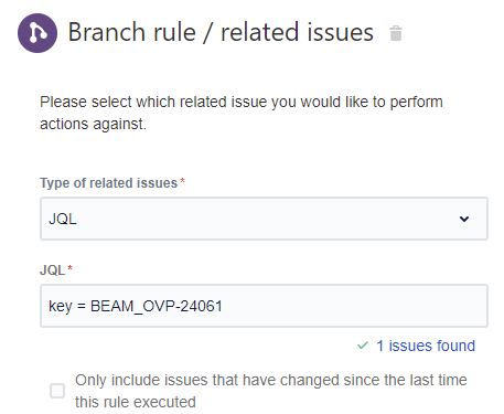

Initially I suspected the received data used to craft the JQL was incorrect, so I hardcoded the JQL statement to one specific issue that exist on the server (as can be seen below).
But this did not resolve the issue.
If I modify the trigger to a scheduled one, and run the rule manually, the branching condition works as expected, and Debug 3 tag appears in audit log:
