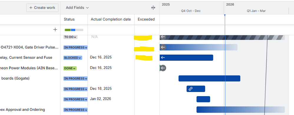

In JIRA timeline - It is normally Start date and due date is seen if you hover over any bar of task, I want to know if I add one field "actual completion date" then can I see also in the bar actual completion date ? so that the bar shows in same bar - Target completion and actual completion. so that with this view - we can able easily see in that single bar - both dates and delay portion can it be with different colour ?
Is this possible ? and if Yes then how we can set it in configuration ?

Jira Timeline can show Start Date + Due Date only.
A custom field like “Actual Completion Date” cannot be shown on the same bar.
Jira does not support dual-color bars (target vs actual) in Timeline.

Thanks a lot for this answer. I thought of adding actual completion date in plan column and I did this with Automation query. However I also need add one more Column Delay (Exceeded) in that plan so that we can atleast see delay in column. I took a help from Copilot to set the rule for this Delay (It should be in Numbers, like no of days). So i did multiple trials with normal as well JSON code. But I am not getting the result.
Could you please support here how to set the rule to calculate and show delay in that column  "Exceeded"?Screenshot 2026-01-02 162518.png

No, that is not possible.
In a Plan in the Timeline view you can add the Actual date field to the Custom fields that are displayed, but you cannot show three dates on the bar.

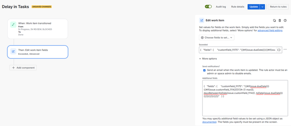

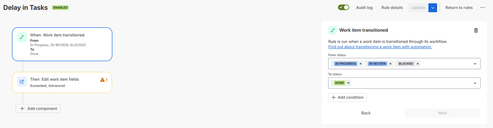

Thanks a lot Trudy, Yes sorry , I forgot to paste Automation rule which I applied, Please find here.
Step 1:Step 1.png

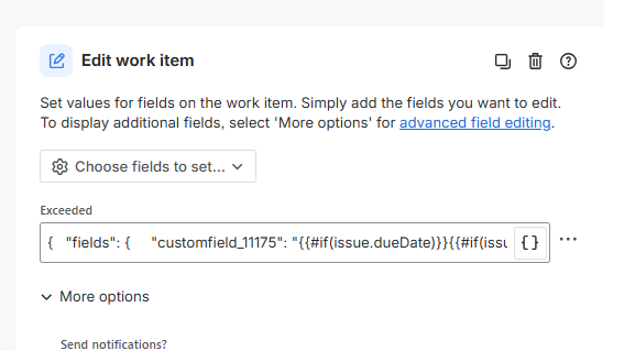

Step 2 : I just paste my rule in Additional Field so that you can see it. This Rule I put in Exceeded Box (Just above that additional Field and run the program).
Meaning of Exceeded- No of Days task got delayed from Due date. name of this custom field is "customfield_11175" and type is Number , I created this.
Actual completion date is another custom field I create - name is " issue.customfield_11142"
and Due date name is - "issue.dueDate"
Also I am pasting here that rule :
{ "fields": { "customfield_11175": "{{#if(issue.dueDate)}}{{#if(issue.customfield_11142)}}{{#=}} max(0, daysBetween(toDate(issue.customfield_11142), toDate(issue.dueDate))) {{/}}{{/}}{{/}}" } }
Could you please help me - whether it is correct or not ? I generated this rule from Copilot, But I am not getting date difference in Number format in Exceeded Column which I shared you earlier.

With the trigger you have set on this rule, the Exceeded value will be calculated only when an issue transitions to Done. If the dates are changed, the Exceeded value will not be re-calculated. To re-calculate, based on just this rule, you would have to change the work item Status back to In Progress, In Review, or Blocked and then transition it to Done again. Is that acceptable to you?
As for the actual calculation of the value the syntax you inserted to set the value is not valid in this location:
You can't use JSON syntax there. If you want to use JSON syntax that can only be used in the More Options area.
I'm not sure if the syntax you have used for nesting IF statements is valid. I don't regularly work with IF statements. I think that nesting IF statements in that manner is not valid based on discussions such as the one in this post:
https://community.atlassian.com/forums/Jira-questions/Automation-using-If-statement-in-smart-value-for-quot-Edit-work/qaq-p/3152717
