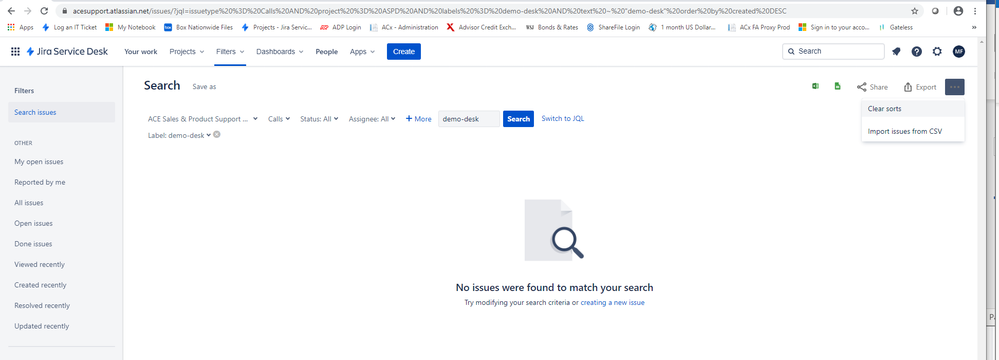

maficca
April 19, 2020
i have tried to add a screen shot to show my filter in case that is the problem but that is not working either.  I am so frustrated right now.

maficca
April 19, 2020
maybe it worked that time?  Can you see a screen shot?
John Funk
April 20, 2020
you don't have any issues from the filter so you wouldn't get the menu. Click on Switch to JQL, then type this in the filter:
labels = demo-desk
then click search. You should see a list of issues come up.

maficca
April 19, 2020
I have added a screen shot since I do not have that option from the 3 dots.  I think i must not be doing the filter correctly.
