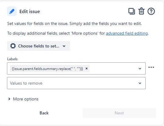

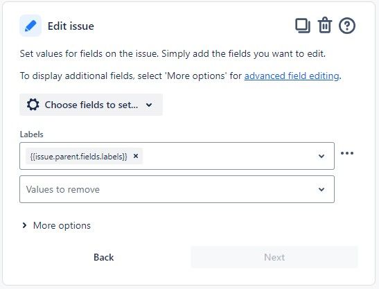

Okay so I solved this myself. Solution below for anyone that may need it
This is the automation rule: When a new sub-task is created (Blocker in my case), the rule is triggered, it then looks for the parent of the sub-task and takes the summary of the parents parent and inputs it into the label field of the parent task (it removes the spaces automatically). After this the sub-task is then edited and the labels from the sub-tasks parents are copied to the sub-task. This completes my requirement.
The branch 'Then' rule is setup like this:

The last 'Then' rule is setup like this:
