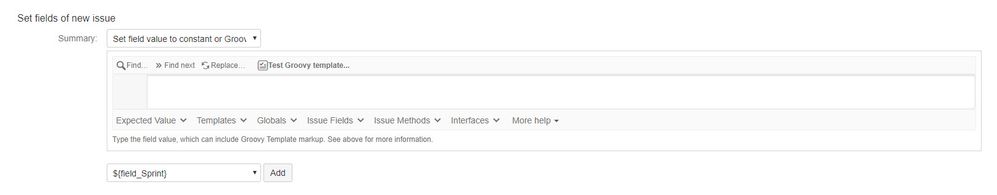

So, for JMWE, you can use the Create / clone issue(s) option.

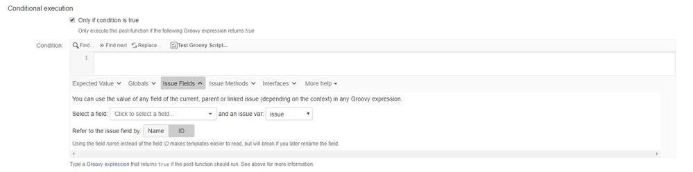

Example: If Field A = Grade A and 5, then there should be a post function that is looking for that criteria. If that criteria is met, then that post function will execute. In your case, you need to use the Condition execution option to test the cascading field.
Use the Issue fields option to find your field, then try testing it once you have it configured. This will support your criteria (Grade A, 5). From there, you can then set the fields to copy over. Issue Fields.jpgThis should be straight forward.

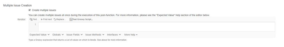

Then, use the Multiple Issue Creation option for the 5 issues.
Mulitple Issue.jpgThe order here is not the same as in the post function, but I think you will want to work on the condition piece first to confirm the criteria. Additionally, this is only a recommendation. I'm sure your use case is a bit more complex than what I'm describing, so use my suggestions as suggestions only. You will find a number of options will work just as well. This seemed straight forward and very intuitive for me.
