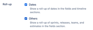

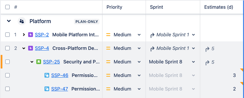

From a sample plan:
Key settings:
  • In Plan Settings > Scheduling make sure that estimation is set to days
  • In your plan's View Settings make sure to check the box next to roll up > others
Then you should get the above result.
