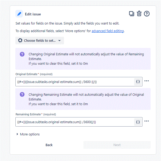

I want to establish an overview of the summarized Original estimates and I succeeded in summarizing Original Estimates from sub-tasks to their parent (task level) by using the following rule:
{{issue.subtasks.Original Estimate.sum.divide(3600)}}h
See below trigger used.
Additionally, I would like to summarize Original Estimates from tasks to their parent (Epic level) and the logic rule for this is:
{{issue.tasks.Original Estimate.sum.divide(3600)}}h
However this does not work.
How do I summarize Original Estimates from tasks to their parent (Epic level)?

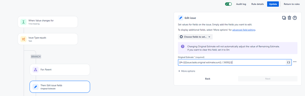

  • Trigger: Field value changed
    • Fields to monitor = Time tracking
  • Condition: Issue fields condition
    • Field = Issue Type
    • Condition = equals
    • Value = Task
  • Branch: Related issues
    • Type = Parent
      • Branch-Action: Edit Issue
        • Field = Original Estimate
          • Value = {{#=}}{{issue.tasks.original estimate.sum}} / 3600{{/}}
I've used "/3600" as my default time unit is hours, if your default unit is minutes, you would use "/60" instead

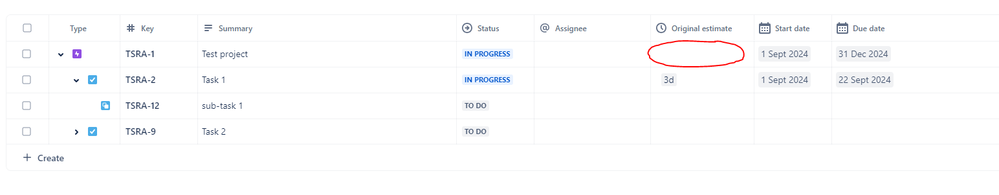

I have implemented your suggestion above. However, it doesn't seem to work on my end. The below shows how it looks.
I would like to have the Original Estimate summarized in the red circle below.
I would be happy if you could help me further on this.

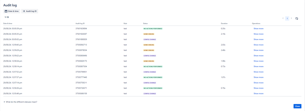

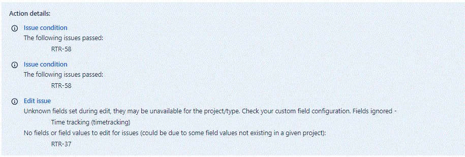

What does the audit log of the rule provide as feedback?
Søren Rangstrup
August 29, 2024
Hi Marc,

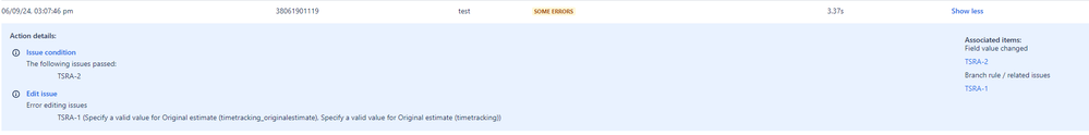

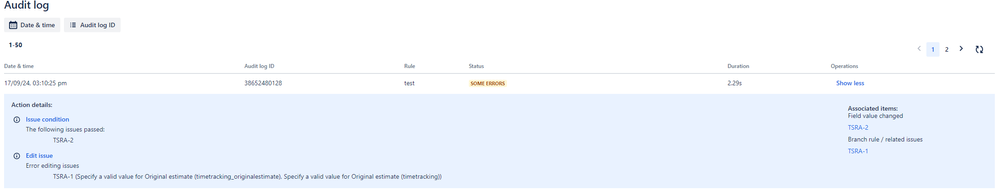

Please see below.
Marc -Devoteam-
August 29, 2024
What is the message, you get when an error is occured?
Søren Rangstrup
August 29, 2024
Please see below. I would appreciate your feedback to help me solving this.

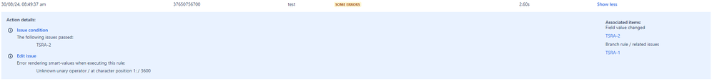

Søren Rangstrup
September 6, 2024
Thanks for your feedback. However, it still doesn't work.
Udklip.PNG I got the following error:
I hope this can help you to see what is wrong.

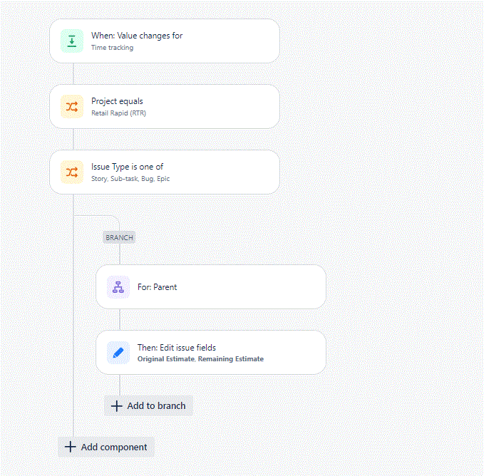

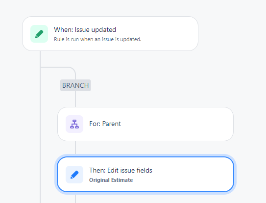

Helen McSparron
September 16, 2024
I would like help with the above issue as well. I get so far, but my error is different to the user above. This is my query (following your example)
This is the error message that I get in the log. I am sure the Time tracking is correct, Original Estimate is on all issue type. Wondering - is the configuration case-sensitive?Capture3.GIF
