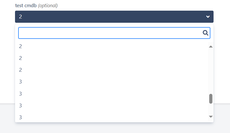

Hi all, I'm developing a jira plugin custom field extends SelectCFType class, and I Override the OptionsManager.getOptions() function, but when I refresh the portal, the options will be rendered repeatedly like below. Could anyone solve this?
And here's my getOptions funciton.

The root cause of the problem is the line below:
options.add(ComponentAccessor.getOptionsManager().createOption(fieldConfig, null, Long.valueOf(id), key));
This line creates new Option instances every time the field is rendered. Every time this code runs, it adds the new Option to the database.
You must retrieve existing options, not create new ones each time. Options should be defined once (e.g., during configuration or plugin install) and only fetched during rendering.

Oh I see. I solved this problem using your method. Thanks very much!
