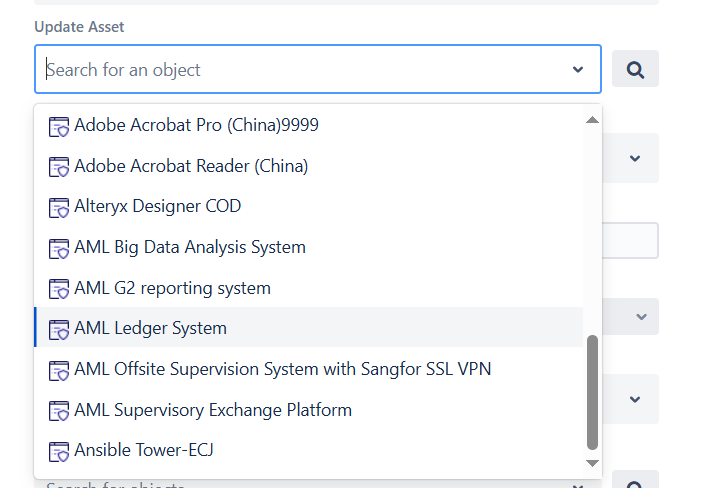

Hi, everyone. I want to develop an Asset Picker but I have no idea about how to realize it.
Before Effort:
I tried to extend SelectCFType but it can just support String instead of insight object.
And I wanted to use AbstractSingleFieldType<ObjectBean>, but then I found it cannot show on the create portal and it'll be set to Hidden fields with preset value by default.
Here's my goal like below.
Any advice will be appreciated greatly. Thanks in advance!

Insight already provides an object picker field. Why don't you use it and try to implement a new customfield?

There should be Assets Object customfield. See this Article.
If this is Data Center, it might be seen as Insight Object/s. You can configure the IQL filter to restrict selectable assets.

In case you are aiming to develop an Asset Picker for Jira, my first advice would be to see if you can make do with the Assets Object custom field that comes out-of-the-box. It gives you an object picker and can be customized with an IQL filter to narrow down the assets that users can pick. Developing a custom field might not be necessary here.
In case a completely different kind of picker is required, it might be worth checking Jira's Forge custom field implementation and developing a custom experience using either UI Kit or Custom UI. It all depends on your setup - Jira Cloud or Data Center and the way in which you want to store the selected asset data.
