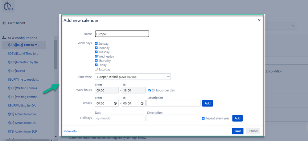

Karolina Wons_SaaSJet
January 17, 2022
Hello @Christopher Simonian
As an alternative solution to those are above, you can try a third-party add-on developed by my SaaSJet team - SLA Time and Report for Jira. All you need is to create necessary time zones and save in the add-on.
PREMIUM
