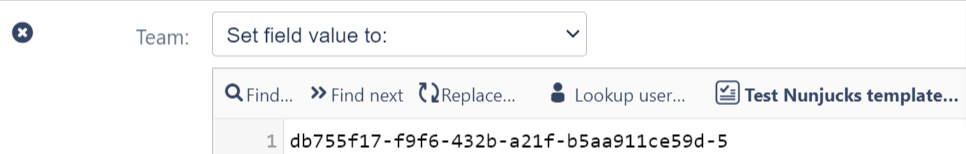

db755f17-f9f6-432b-a21f-b5aa911ce59d-5; (the image above)

But none of them worked. I always get the error: "Team with ID 'db755f17-f9f6-432b-a21f-b5aa911ce59d-5 ' could not be found" (or something very similar).

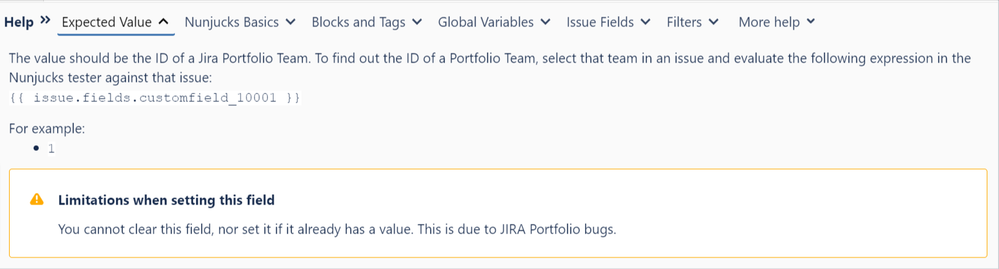

Hi @Marcelo Valença ,
can you please share a screenshot of the "Expected Value" help tab of the value editor for that field?
as you can see, this field is an Advanced Roadmap for Jira (formerly Jira Portfolio) field. As such, it is only available if you are running Jira Software Premium. Are you?

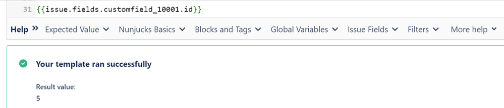

Then the ID needs to be a number. To find out that number, assign the Team to an issue and test the following expression against that issue:
{{issue.fields.customfield_10001.id}}
Note that the team needs to be available for the current project.
@David Fischer yes, this was one of my first attempts, but it didn't work:
The team ID is 5:

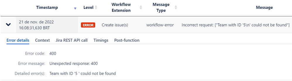

but when I try to configure it, I always get this error:
Do you have any idea what is possibly going on?
From the error message, it looks like there's an extra newline after 5. Can you check the value entered in the editor?

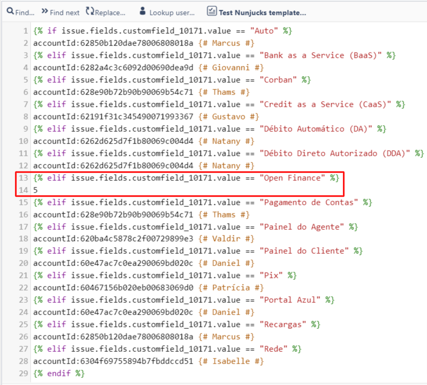

This is exactly how my code is:
Unfortunately there is no extra newline.
Actually, there is. Plenty. I count 29 lines :)
That's because you do have newlines in the Nunjucks template, to make it look better. The solution is to use the "whitespace control" feature of Nunjucks, as explained in the "Blocks and tags" help tab. For example:
{% if issue.fields.customfield_10171.value == "Open Finance" -%}
5
{%- endif %}

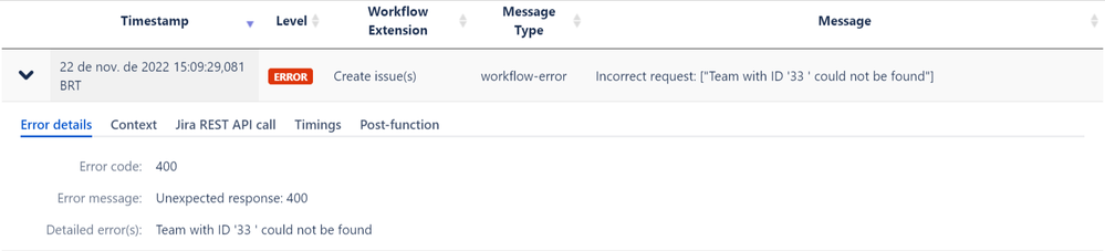

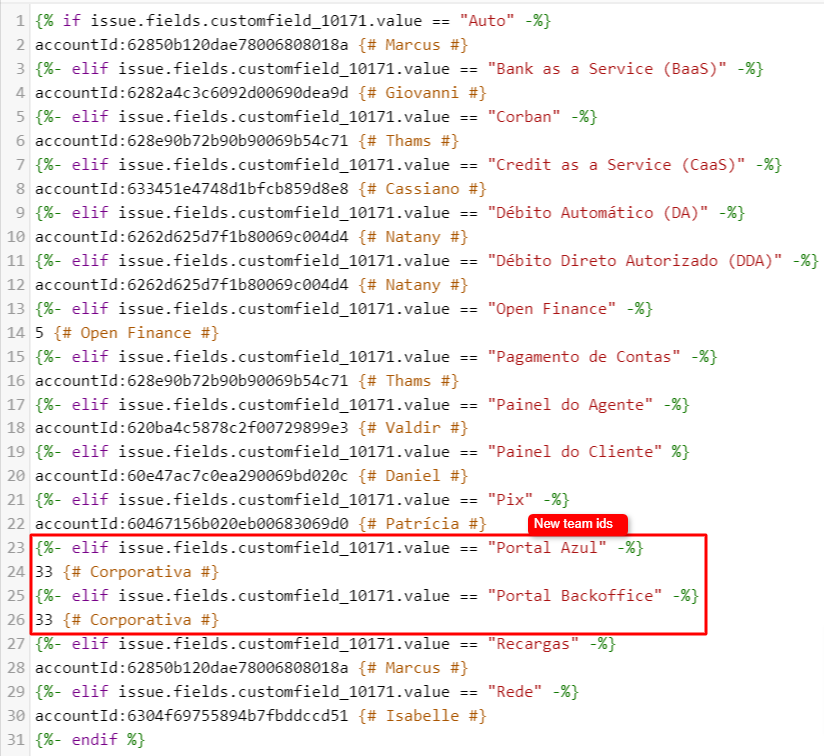

@David Fischer, I continued to edit my code to consider the other teams and, when I did so, the error happened again. I only added another team ID in another line. Can you help me to understand what is going on?
This is the error in the log:
