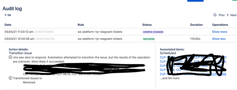

With the current automation audit log tab I can only see partial logs, is it possible to see a complete audit log?

@Bill Sheboy I attached the screenshot, based on that you can see the audit log message is getting truncated after some characters, couldn't find a way to read the complete message. For my debugging purposes, I need to know all the tickets got impacted by this automation rule.

Thanks for clarifying, and I agree that the audit log seems incomplete in that regard.  Without knowing more about your rule structure, I can suggest the following work-arounds:
If your rule use JQL to gather the issues, AND did not change the conditions used in the JQL, you could re-run the query later to determine which issues MIGHT have been impacted.  I note "MIGHT" as they may not have all processed...again, this is based upon specifics of your rule.
Otherwise, you could add some additional logging / data capture for processed issues:
  • Use Lookup Issues to gather the list of issues and log their keys.  This might have a limit also
  • Log each issue as it is processed.  There appears to be a 100 entry (and time-based) limit in the audit log, so this will truncate over time.
  • Use Lookup Issues to gather the list and send yourself an email with the processed issues.

Again, I am guessing here as I do not know what your rule looks like...  Here are some scenarios to consider:
  1. Let's say your rule has a scheduled trigger on JQL.  That means each issue is processed one by one.  As you process each one, use an Action of Log to write the key with {{issue.key}}
  2. You may use the same approach as #1 if the issues are processed within a branch
  3. If you are creating issues, you may log information about the last one with {{createdIssue}} or the set of created issues with {{createdIssues}}
