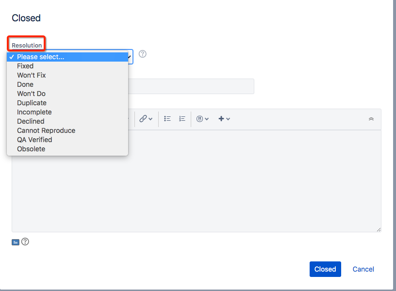

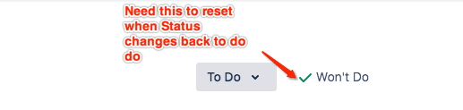

Hello,
Within Jira, when we transition the issue to 'Closed' we have a screen where we can fill in the 'Resolution' field.
If I transition it back to 'To Do' how do I reset the resolution field so that its blank again?
Thank you!

See: https://confluence.atlassian.com/jirakb/clear-the-resolution-field-when-an-issue-is-reopened-in-jira-server-648381467.html
Note that resolution is required whenever it is shown on a screen so to remove it you need to run a post function as described in the attached link. (The approach is the same for both server and cloud)

You need to edit your workflow
On-screen from Closed -> To Do
  1. Add a post-function
    1. Update Issue Field  -> Resolution -> None
BR, Olga
