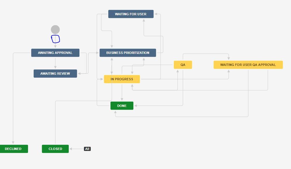

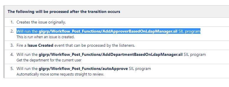

workflow.JPGpost funtions.JPGSo right after the ticket is created, it goes to the approval step. My theory is that it's hitting that approval before the post function finishes running.

Does it make a difference if you move the function to position 3 ? I think my advice about the position was not quite correct - take a look here Customizing workflows
Here's the quote from the docs:
Note
When writing post functions, conditions or validators for the Create issue transition, ensure that the SIL program is the last step of the transition. This is necessary because we need Jira to create the actual issue and save it to the database using the input parameters before we can access it.
Note
In general, it's a good idea to place your post functions after all standard post functions.

I reordered and still the same result. By default, will jira finish running the script before it actually moves to that status? Is there anything I might want to check in the logs? I got in there before and wasnt 100% sure what I was looking at or for. All the other notifications are working as they should.
