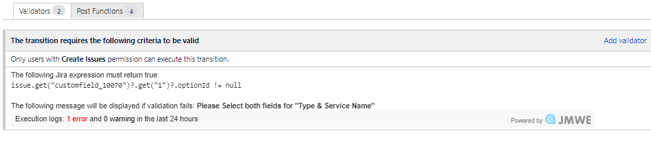

Use the "Linked issues Status Validator." In the groovy script field, enter the following:
issue.get("customfield_19900")?.get("1")?.optionId != null
Adjust your custom field ID as needed. get("1") refers the second field of the cascading list.

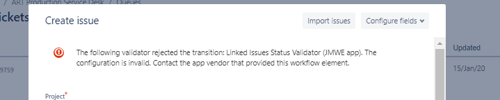

I have included above script with my Custom field ID.
But still i have an error when creating Issues even-though selected cascading second value.

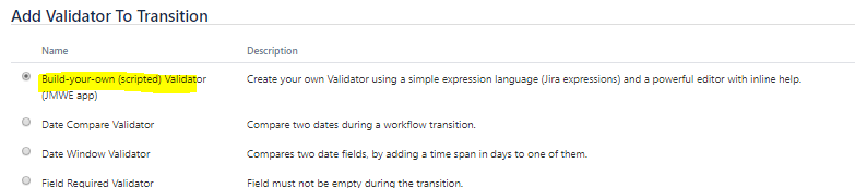

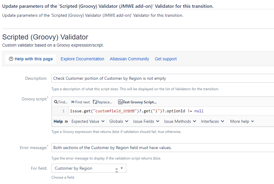

Based on the error, I think you are using the wrong validator. It's called "Scripted (Groovy) Validator (JMWE add-on)" on the validator page.
Here's a screenshot of my implementation:

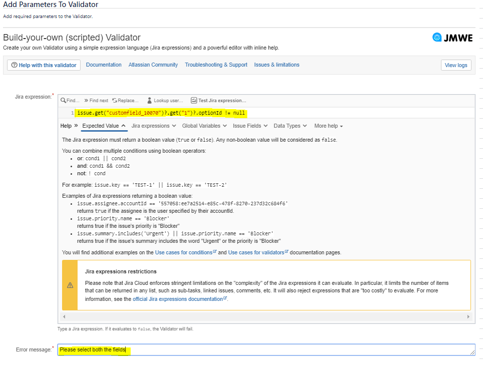

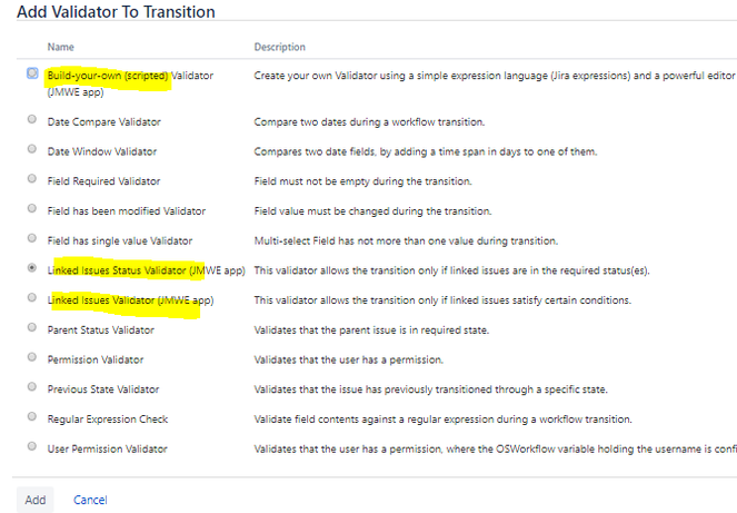

This time i tried below mentioned Validator. (Refer Image 1)
Image 1

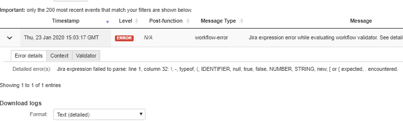

After that, added your script. (Refer Image 2)
Image 2
But Still i got error.
Error detail Snap below
It will be so helpful if you let me know where i went wrong.

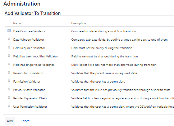

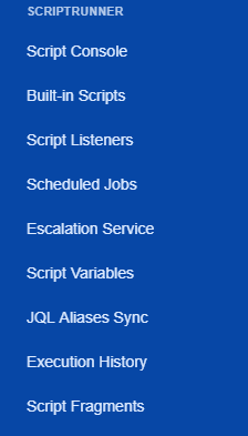

how to add "Script Validator", i don't have option in script runner. Please share some steps to add "Script Validator"
where i have to add this line "cfValues['your cascading field']?.values()*.value.size() == 2"
i only having below options.
