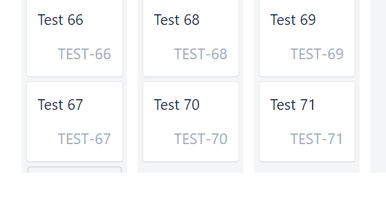

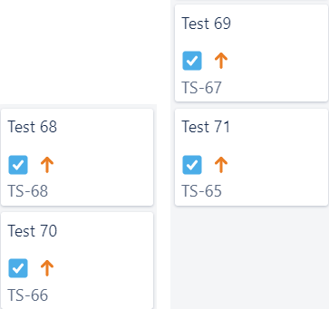

Hi,
We want to upgrade our JIRA core to JIRA software. We need to move the issues in JIRA core project to JIRA software project. I searched solution in following URL.
https://confluence.atlassian.com/adminjiracloud/convert-project-to-a-different-template-or-type-966673096.html
However, when moving the issue to new projects, ticket numbers were always changed. See the picture. How can I keep the ticket number?
Before moving:
After moving:
John Funk
April 24, 2020
Hi Shawn,
I am not sure how you can do that. You can try to follow what Kristjan suggests. You would need to export the full issue, and then import it into the new project using the guidance in the above post.
But the problem is that the new project MUST have a different code for it - you can't reuse ones. So if your current project is ABC and all of the issues are ABC-1, ABC-2, etc. Then the new project cannot use ABC - it must be something different.
John Funk
April 24, 2020
I guess you could do the export, then change ABC to ABC2 or something like that - which will convert all of your existing issues. Then create the new software project as ABC. Then import the original ones you exported with ABC. Then you would just delete all of the ABC2 issues.
I would try that with a handful of test issues you create in a new test project first, including adding some links to other cards to make sure you don't lose the links.
