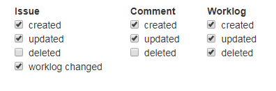

I am new to Atlassian programming and I want to invoke an external application via REST when an event is fired in JIRA, for instance when the priority of an issue is changed. (An event is fired when I change the priority in a JIRA issue, isn't it?)
I have registered the URL of a SpringBoot application as a webhook in JIRA so that this springBoot app shall be informed via a REST call that something happened in a JIRA project.
Did I understand webhooks correctly that I can use them this way?
How can I achieve that the event gets to the SpringBoot app/webhook?
Is there a way to test that an event is really fired from wihtin JIRA? How can I test this?

In your Webhook configuration, you have issue-updated checked?
D. U.
December 16, 2017
I tried this in the meantime because I didn't had any else idea. ;-)
The checkboxes weren't activated because I thought that when "All events" is used I don't have to check the checkboxes.
However, Josh, you were right! I didn't checked them...and that was the problem.
Thank you, Josh! :-))

My SpringBoot app's method defined in the webhook now is called...but unfortunately only when I edit a comment. Not, when creating a new issue or reassigning the issue to another person, .. What do I have to do here?
