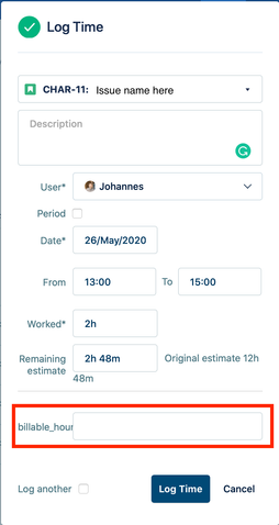

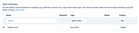

Tempo makes it possible to extend the Worklog Model with custom fields.
So this is not a Jira Custom Field (that I could currently choose in Structure), but a custom field on each WorkLog.
We want to have two pieces of information on each worklog: The plain time the employee worked and the (ScriptRunner) calculated billable_hours (depends on a user factor).
We want to use these billable_hours in our Structure (Invoice View 2020) to get the number of hours, that we can actually charge the customer with.

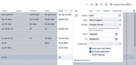

Therefore it would be necessary to not only sum the spent time of worklogs in a custom period (what structure currently does).
We would need to select the custom worklog field (billable_hours) and sum these times in the custom period.
This would add huge value for us since we wouldn't have to rework worklog hours manually before creating an invoice.

Here some explaining pictures:
Johannes Strodel
May 26, 2020

Thank you for sharing more details and for sending the screenshot. If I understand correctly, you need to be able not just seeing the Billing Hours attribute in an issue, but to see it both for a certain period of time and logged by a certain user. I will pass your request to the team and if there is any news about the implementation in the future, we will let you know here.

But being able to see how many billable_hours were made in e.g. month Mai on each structure "level" (e.g. Epics sum billable_hours of connected Storys in month Mai) would be awesome and would save us from adding another tool/step into our billing workflow.
