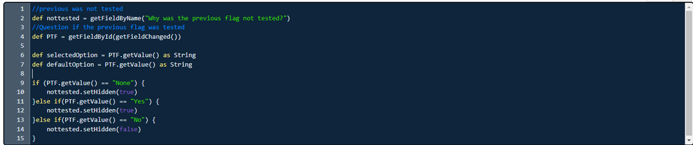

I am making a field Hidden or not hidden based off a drop down selection. I can get it to work, but the default "None" in the drop down isn't recognized by my behaviour and doesn't Hide it or make it appear. Is there a way to code it so that it can read the default option? See code below:image.png

Hi @Aaron Andrade
Try
 if (PTF.getValue() == null)
instead of the == "none"
Thanks,
Tim
Application Administrator
February 8, 2022
Tim,
         Thank you for the help! That did work for me, I just can't believe I didn't think about doing that. It usually is the simple things. Thanks again!
