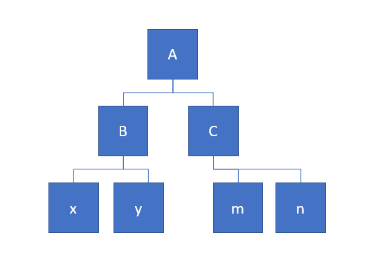

Hi,
I tried to search existing posts, but did not seem to find anything similar to my question.
I have an issue hierarchy something like this:
A linked to (consists of) B  and C
B linked to (consists of) x and y
while C linked to (consists of) m and n.
I would like to query what are the leaf issues in above example, i.e.: x, y, m, n by using A as the indicator (query input).
Is it possible?
I know for one layer, I can query out B and C by using :
issue in linkedIssues(A, "consists of")
but I don't know how to get the further layer, the x, y, m and n.
Thanks

Hi @li chen ,
I have seen this case. A has no relation to the lower layers. The design is to search for direct links. You may want to explore the middle layer and query from there since it has connection for top and Bottom layers.
Hope this helps.
Thanks,
Ben
li chen
August 31, 2021
Thank you Ben, I just found this post,
https://jira.atlassian.com/browse/JRASERVER-21936?error=login_required&error_description=Login+required&state=e8be95ba-dff2-4c91-9058-eee5c377073b
with "nested JQL function calls", I maybe able to do it, I was just wondering is there any native supported function that might be meeting this needs.
Benjamin
August 31, 2021
You welcome. none that I'm aware of. There are add-ons out there to extend the JQL but you want to make sure you choose the right platform since some of them are only support on server/DC and not on cloud.
