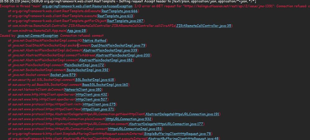

I am trying to send request to JIRA cloud server which we have to fetch REST APIs through Spring Rest Template. But I am unable to establish connection. In console it is showing like connection refused.JIRA_error.JPG
I am using Spring Rest Template basic authorization feature. Kindly help me how to establish connection from Java to Jira. Also I have tried JRJC library, there also its showing same console error.

Did you first try with "curl" from command prompt? Is the curl command working fine?
Abhishek_Pattanaik
December 13, 2017
I am able to fetch data when I check from Postman

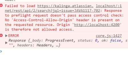

Tarun Sapra
December 13, 2017
have you tried jsonP with angularjs?

Hey...thanks for your quick reply. I am able to fetch data using Spring Boot rest template. My system was under organization proxy control so I set the proxy and now able to fetch.
Only one query, how to do this on Angular 5 if we are under proxy.
Thanks
Tarun Sapra
December 13, 2017
angular is also running on your localhost, so if you local system can pass the proxy thus so can angular code. You have to make sure that your local system is allowed to cross the proxy and use JsonP concept in angularJS
