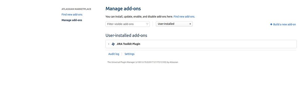

Thanks for your response. I don't have access to the company mailbox right now. I see all the messages at jira issue collector. I'll try to access the mailbox directly and confirm. By the way, for sending the message from website, phpMailer has been used: https://github.com/PHPMailer/PHPMailer/blob/master/examples/contactform.phps
I haven't found any installed plugin for email handling. That means, it was configured without plugin probably.
existing-add-on.jpg.

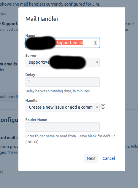

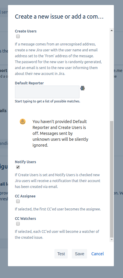

By the way, here is the configuration what I have found in jira:
Screenshot from 2017-12-20 18-41-46.pngScreenshot from 2017-12-20 18-45-55.pngScreenshot from 2017-12-20 18-47-51.png

As mentioned in the configuration "You haven't provided default reporter" , thus if the "from" email address is not mapped to any username then it will be ignored. Thus, your company address is mapped to some username which becomes the default repoter.

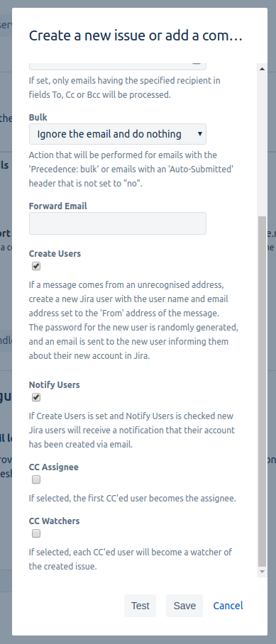

Sayyedul
December 21, 2017
By the way, I've tried with checking Create Users checkbox. still no change!
