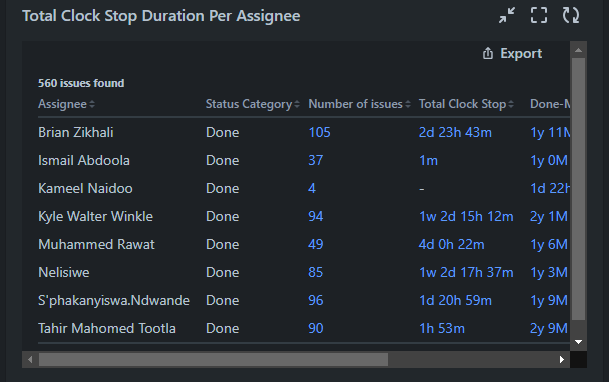

Hi,
So within our Jira, we have multiple Team managed projects which are our customers (we have multiple request types that are for support tickets, asset repairs and such)
Now, what is required is a report or dashboard to display this
Which assignee group -> assignee and if they initiated a "clock-stop" which is when the SLA counter is paused, we are in need of a way that can dynamically go through projects or parameters to do then show currently all clock-stopped by who and their member group
We have EasyBi, but doesn't seem to be able to display in this way.
What I tried to do is use status time to make a report, but this isn't what I need. I want to know if paused and who paused and how long this pause is running. Is this possible to go about in a standard way? with EasyBi or this plugin

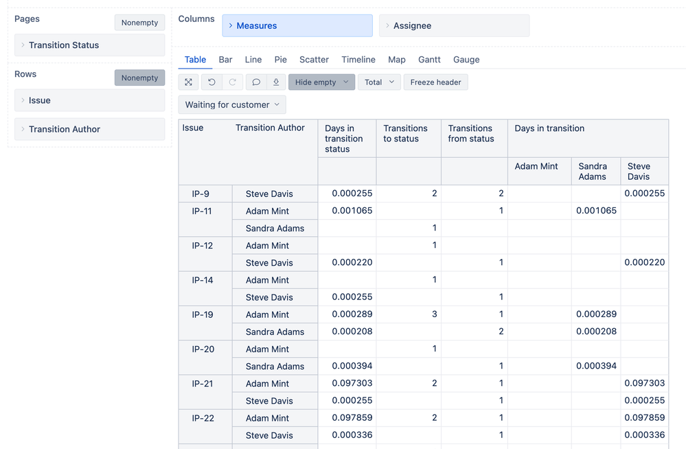

I appreciate your interest in the eazyBI.
We are importing Issue change history data in the eazyBI; please read more here: https://docs.eazybi.com/eazybi/data-import/data-from-jira/import-issue-change-history
In this case, if you have a Statuss assigned to the Paused in the Jira SLA configuration, you can use measures: Days in transition status, Transition Author, Days in transition,  Transition to Status, and Transition From status to report the Paused status.
For example, I have the "Waiting for customer" set as Paused.
Measure, "Days in transition", shows the time spent in this status. You can see that Sandra Adams paused the issue, and Adam Mint unpaused it. The issue was on pause for 0.001065 days.
Measure, "Days in transition", is based on "Transition from status". All the paused time will be shown under the user who unpauses the issue.

Kameel Naidoo
December 6, 2023
I even gave an example of what I need and this in no way accurately reflects the data needed. See image above, I need that in EasyBi

Kameel Naidoo
December 11, 2023
Yes so it goes like such, the arrow indicates a status change.
Work In Progress -> Clock Stop then the SLA config is set to pause on the Clock Stop Status, depending on project and request type there could be 3 statuses that pause clock and so forth, it is not standardized. The only standard is that all our request types contain a status that would pause the respective SLA clock and we are wanting to express this data in a readable/reportable way.
So for Customer 1 there is Clock Stop and Clock Stop - 3rd Party
We want to tell which status it is in, how long the pause is running for and if I wanted to check is it on my internal clock stop or am I waiting on a 3rd party.
Display should then be in this format ideally or closest match, as image above indicates
Person Name | Priority of Ticket | Current Status | How Long Paused
