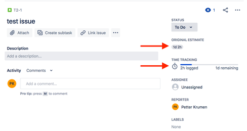

Basically, the time tracking configured for any issues (Including sub-tasks) has three fields:
1 - Original Estimate: This is the initial estimation you have selected for a specific issue.
2 - Time Spent: This is the time you have effectively worked on the issue until now.
3 - Remaining Estimate: This is the current time difference between the Original Estimate and the Time Spent field (Original Estimate - Time Spent)
That being said, I believe that the Time tracking fields display the exact information you are asking for in this statement:
What I am looking for is to see... for the testing subtasks only... How our estimates compare to the actual time logged.
Providing you a practical example of the scenario I described, you can check in the screenshot below that the issue was initially estimated as one day and two hours to get completed. Once two hours were logged, the remaining time is one day:
For more information on how the Time tracking works, check the documentation below:
P.S: To get the time tracking to display only for the specific Sub-task issue you have, you can either change the time tracking field context to only be applicable to that sub-task or simply set a different screen scheme for the sub-tasks.
Let me know if this information helps.
