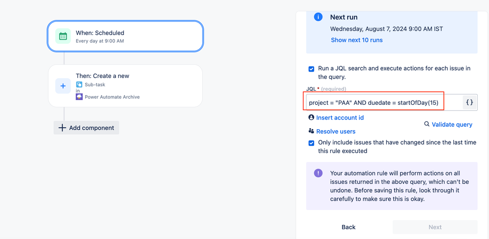

Hi @Javier Peraita  For this you need to create a scheduled automation, which run everyday and check issue in which duedate is equal to currentdate+15. For those issue, it create a sub-task.
JQL : project = "PAA" AND duedate = startOfDay(15)

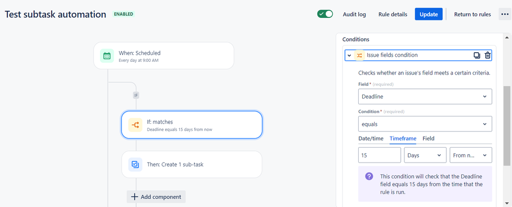

Hi @Vikrant Yadav, thank you very much for your reply. I am testing this solution but it is not working. I have created several issues with different deadlines, however when I click on validate query I never get any results. I have also tried to validate it from the filters section in Jira and it doesn't return any results either.
I have tried another way of filtering (see attached image) and I have not been able to get it to work either. Can you think what could be wrong and how to solve it?
My Deadline field is a custom field of type date and time.

@Vikrant Yadav I am doing it with the JQL code but it does not return any result. Is it possible that it is because the field is date+time ?

@Javier Peraita  It means no issues have Deadline greater than 15 days from now.
Try to create an issue with Deadline 27th Aug , then Do JQL search, issue would be visible.
