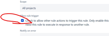

Agree with Mark - that would fire the rule. But you need to check the box to allow other rules to trigger your second rule. You would do that in the Rule Details page.

@John Funk @Mark Segall  Thanks! It works now.

Hi @Gil Blau - My first advice is to make sure that the "Project B Automation" has the checkbox set for:
"Check to allow other rule actions to trigger this rule. Only enable this if you need this rule to execute in response to another rule"
If that is already set, please share audit logs for the failed rule(s) so we can help diagnose a bit further.
