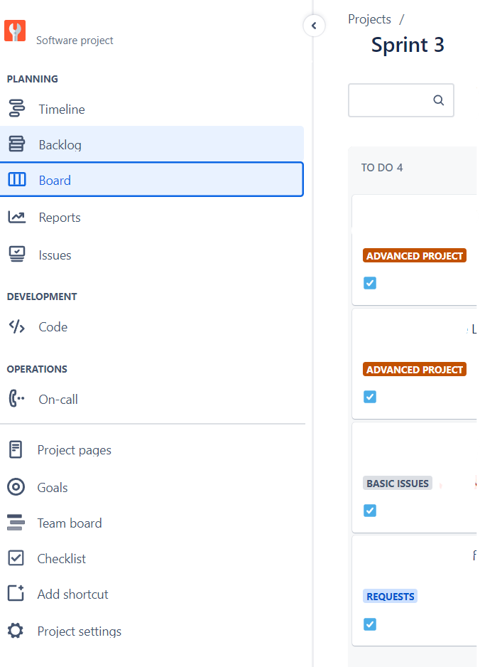

In looking at your image I am thinking that you are on a team managed project. You can verify this by looking at the lower left corner. Assuming that is true then you simply need to go into project settings and then features and disable sprints. Should you ever want to return to scrum then you can simply reverse that. If you prefer to have both boards available then you can follow my original steps below with one additional step and one note...

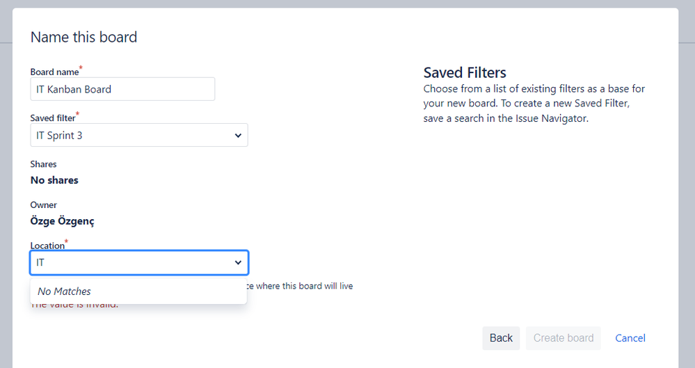

I would like to have both scrum and kanban boards; however, there is an issue. In the search field, I cannot select my project as it does not appear. Is this because it is a team-managed project? How can I fix this?

@Leo Petersen , If you have a TMP then you will need to use your profile as the Location. Feel free to share a screen shot of your project page if you need assistance.

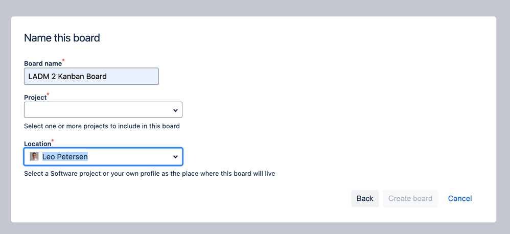

Thanks for that. Yes, I want to add a kanban board for the "SAND9" software project, which is set up with a scrum board. I can choose my profile as location, that works.
The issue is that"SAND9" does not appear in the list of projects to choose from. And as long as I don't select a project in the project dropdown, the "Create board" button is grayed out.

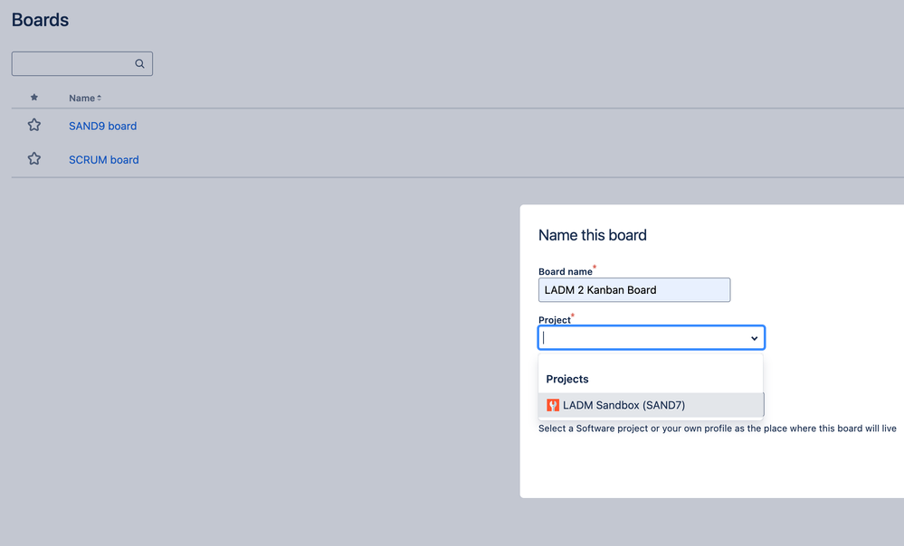

To add a bit of detail: My "SAND7" project, which is a business project, does occur in the dropdown list. But my "SAND9" project, which is a software project, does not.

Is your SAND9 a Team managed project? If so it will not appear there. You would need to choose your profile in the location.
Leo Petersen
June 10, 2024
Yes, SAND9 is a team managed project. I do choose my profile in the location. However, the "Create board" button is grayed out, as long as I don't select a project in the project dropdown.
