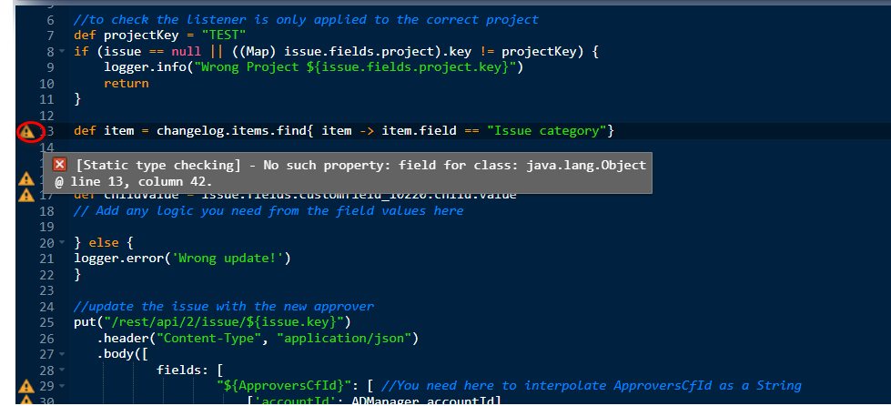

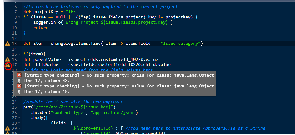

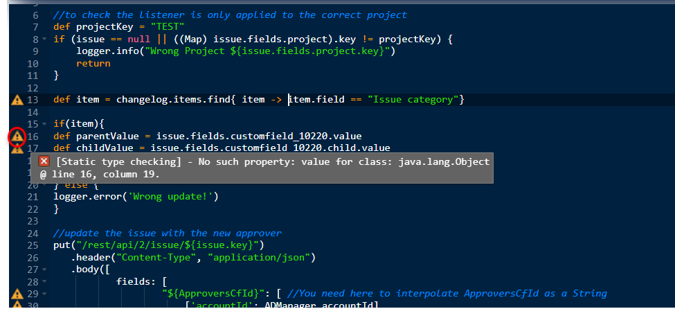

I couldn't get pass the def item code.
Then similarly with def parentValue and childValue code lines.

Those warnings are because the editor doesn't have knowledge of the data type we are processing, but they are just warnings. The script will still work because, despite the editor not recognising it, the data is there. You can add checks by adding '?' before all '.'s.
For example, issue.fields.customfield_xxxxx.value
Becomes
issue?.fields?.customfield_xxxxx?.value.
Regardless, despite the warnings, the script should still still work.
